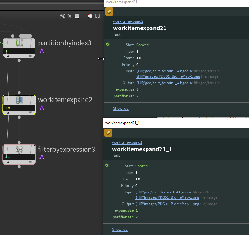

I am not very familiar with PDG yet. Please tell me why I get a warning when the filter by expression node is cooking ?
Edited by Dronson - Aug. 21, 2025 02:52:25
