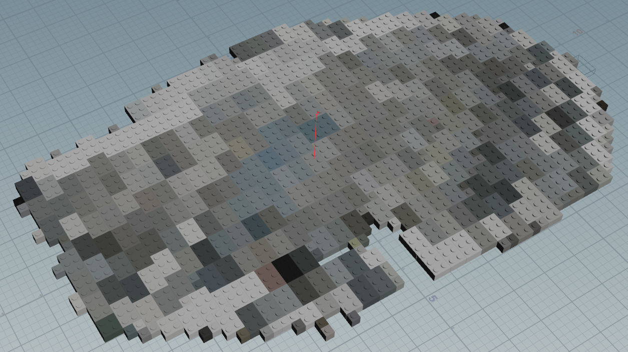

Here is a screenshot of what I have:

I managed to solve the issue. The issue was more me not completely understanding how for loops worked in Houdini. The differences between the input, feedback and piece begin blocks.
I know this image doesn't really say much. If someone wants a more detailed explanation I can write it down.
Edited by FloreV - Nov. 2, 2019 10:36:20
