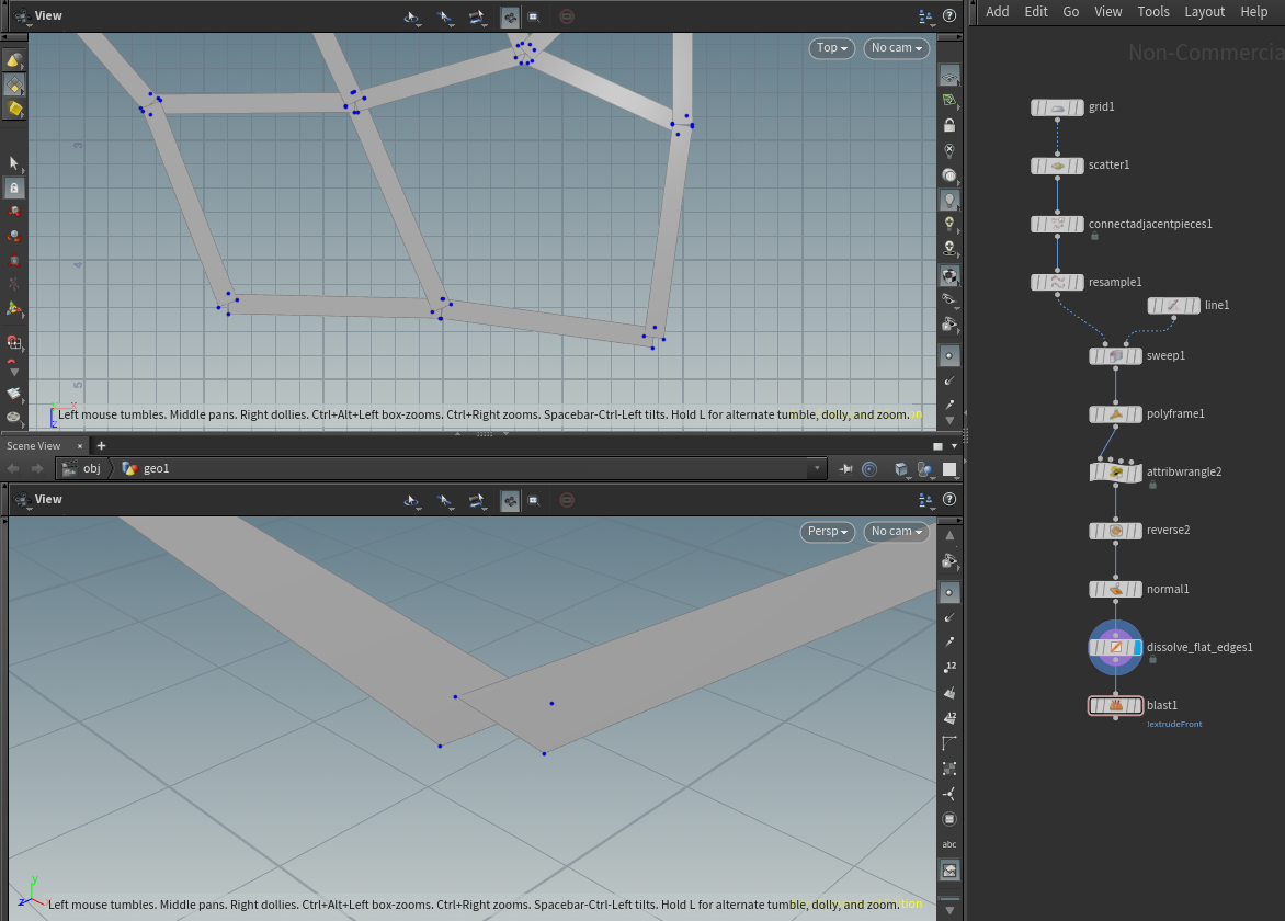

Hi to all,
I am searching a way to beautify these crossroads where 3 primitives overlap.
Can someone point me out a way to achieve this ? Thanks !

For the crossings it is advisable to set up a separate procedure. As a mere by-product of the road generator you will hardly get satisfactory results.
Best you split the procedure into these parts:
- Entire road network represented in curves
- Separation of curves into cross roads and roads
- Road generator
- Cross roads generator

you may want to have a look at this - it's a 3 part series
https://www.youtube.com/playlist?list=PLW_97pCZzzYMEBzYe-lGotQvANKVzbki9 [www.youtube.com]

@Kontantin : I get it… still have to wrap my head around Houdini's way of doing things. I'll work on the cross road generator then.
@goldfarb, the crossroad part of the tutorial is a bit too advanced for me right now but I get the principle. I'll try to cook something from there.
