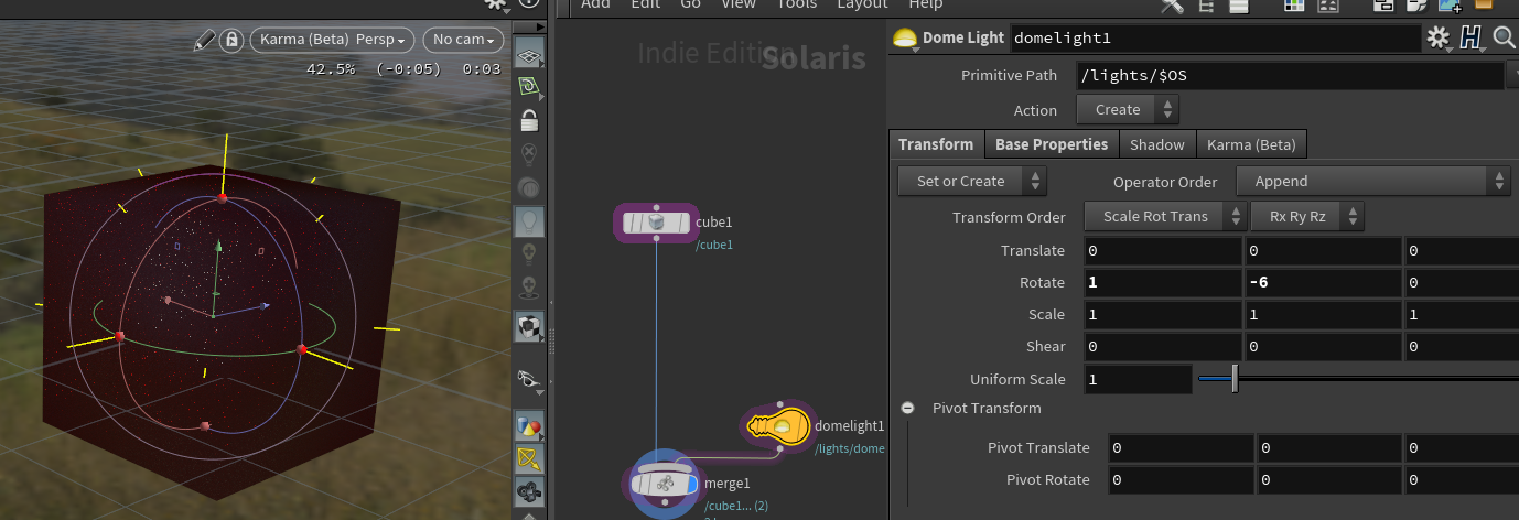

Hello people,
Maybe I'm doing something wrong, but when I try to rotate my dome light on any other axis than Y the render just gets dark and strange,like all directional light is gone. I tried googling but no one else seems to have the problem.
Any help is appreciated!
474 posts
Joined: Sept. 2016
Hi. This bug was addressed in 18.0.411.
Joined: Nov. 2018
Thanks! I installed 18.0.416 and it works great.
