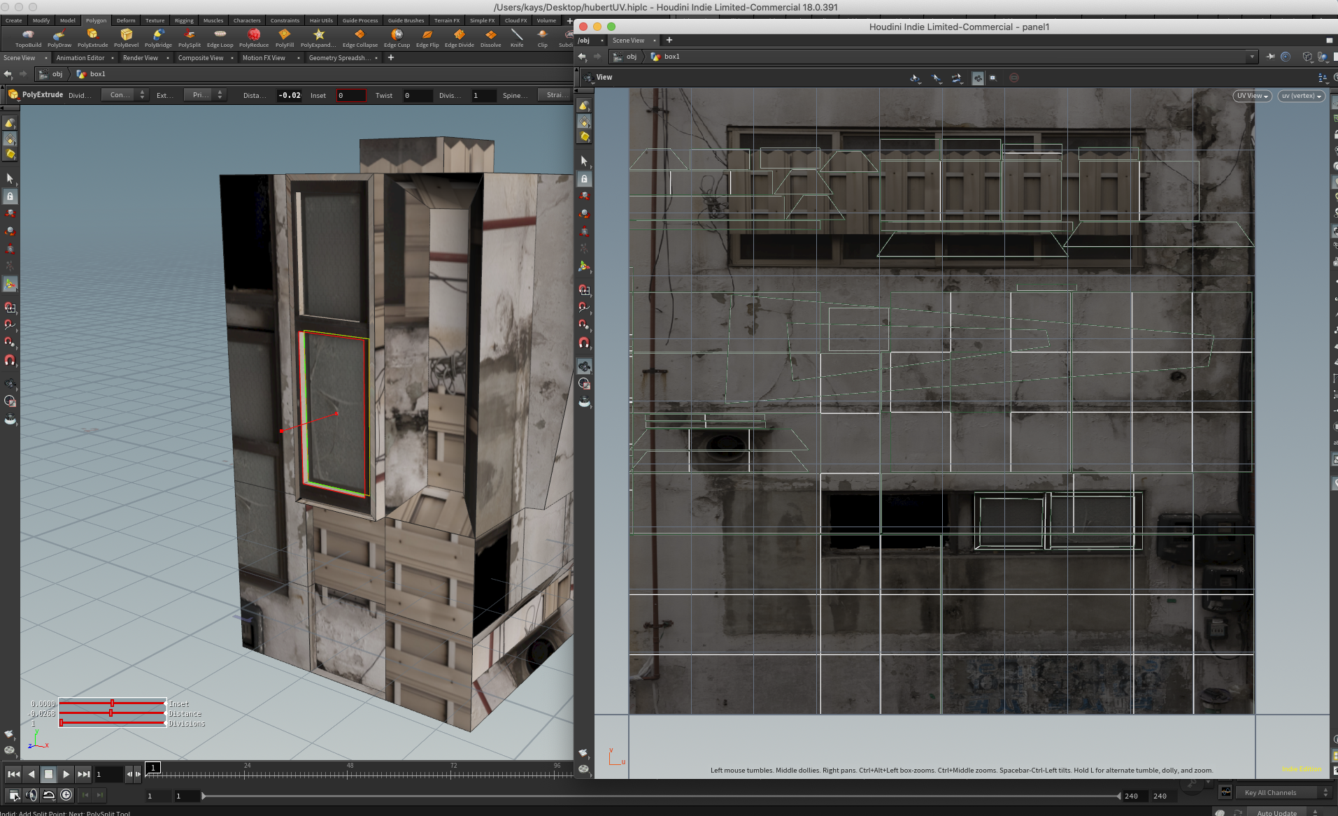

Ok, I think I'm getting the gist of it….basically a combination of UV Texture using Face, UV Layout to make sure all of my polygons are laid flat, and then UV Edit to change the UV location of each polygon.
It doesn't seem quite as elegant as it appears to be in Blender, but I think it's basically what I was trying to figure out.
If anyone else has some other ideas, please chime in!
Screen Shot 2020-04-07 at 3.21.41 PM.png (2.3 MB)
