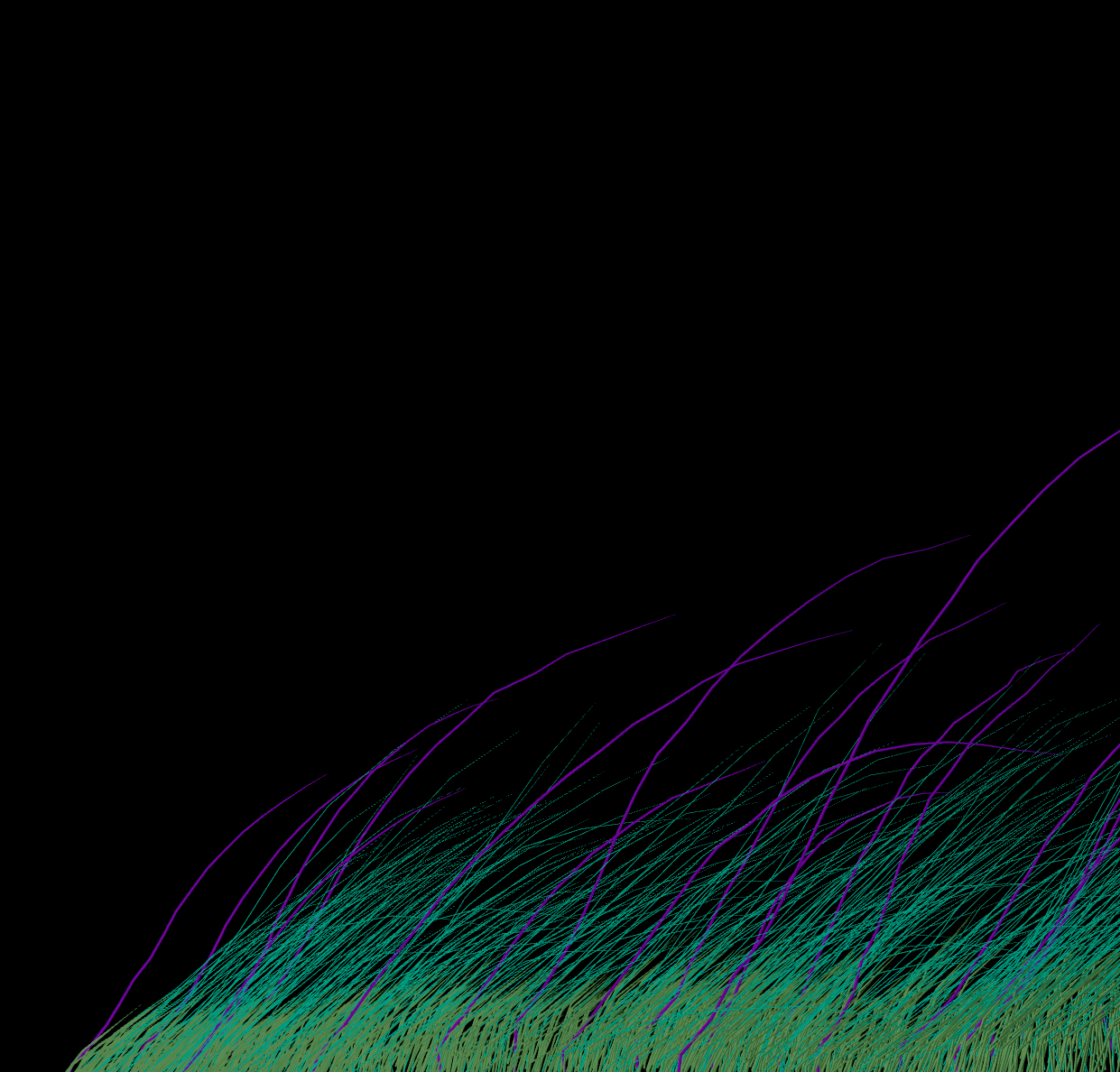

The deformed guides

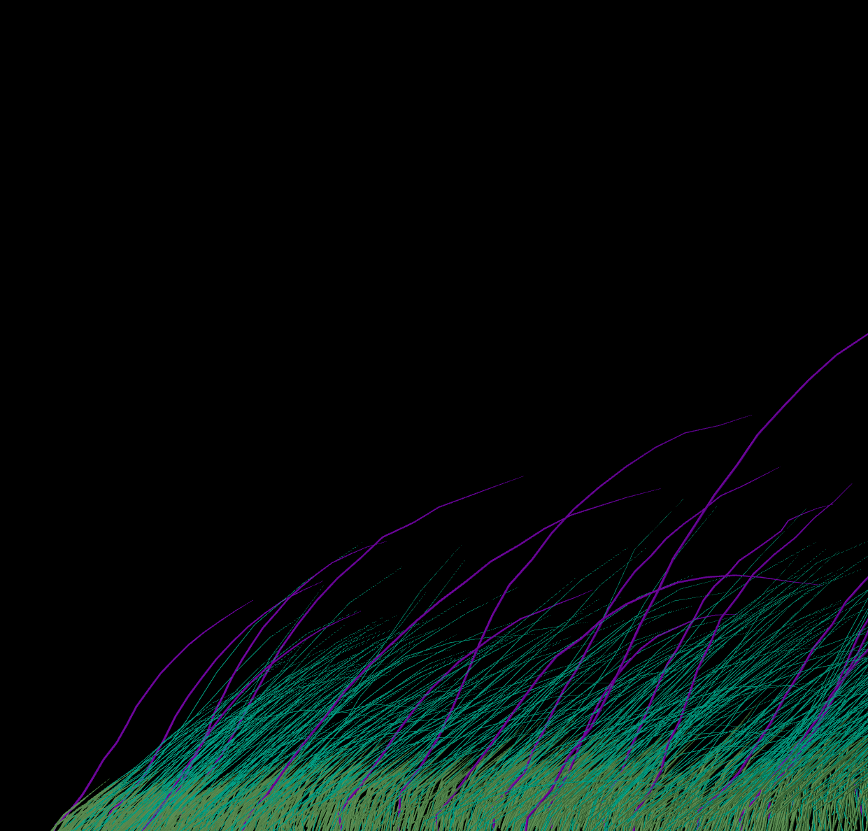

the fully deformed groom

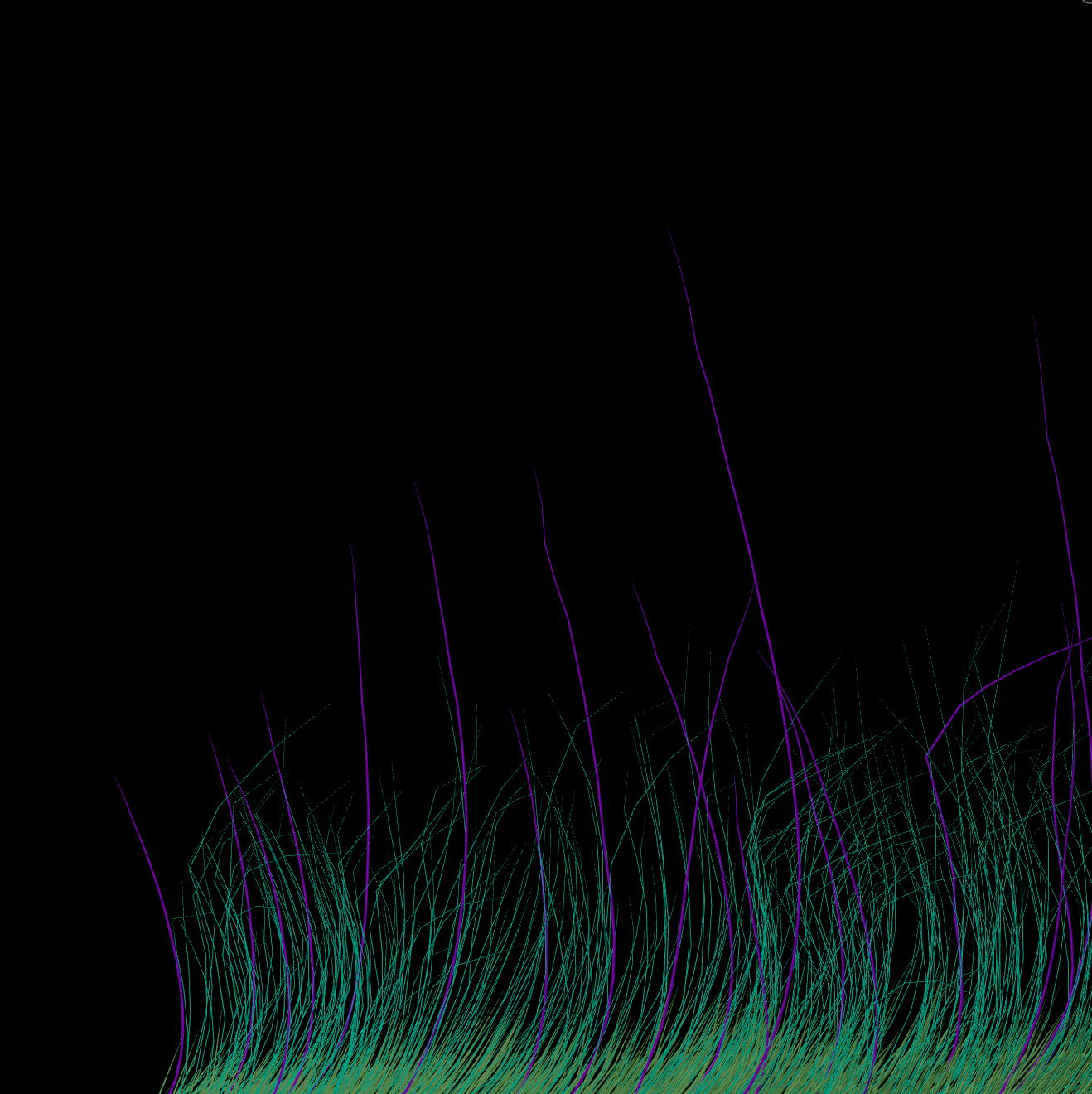

full groom deformed with guides (barycentric weights)

Best
J
