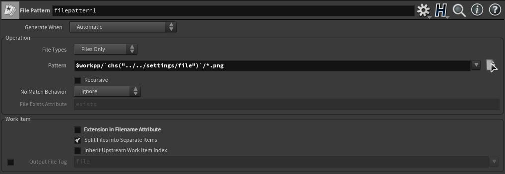

thing is I generate my work items with the file pattern node
the pattern set to a directory
$work/`chs("../../settings/file")`/*.png
to find every image file in that directory
how would I implement this with the pattern parameter set to @pdg_input ?

If you're already using File Pattern to generate your work items, you shouldn't need anything additional. You'll just need to disable the “Extension in Filename Attribute” parameter.

I still get @filename.png overwriting itself until all images are exported
Must be missing something here..

@filename is an expression, so it is required to use backticks (`) around it.
