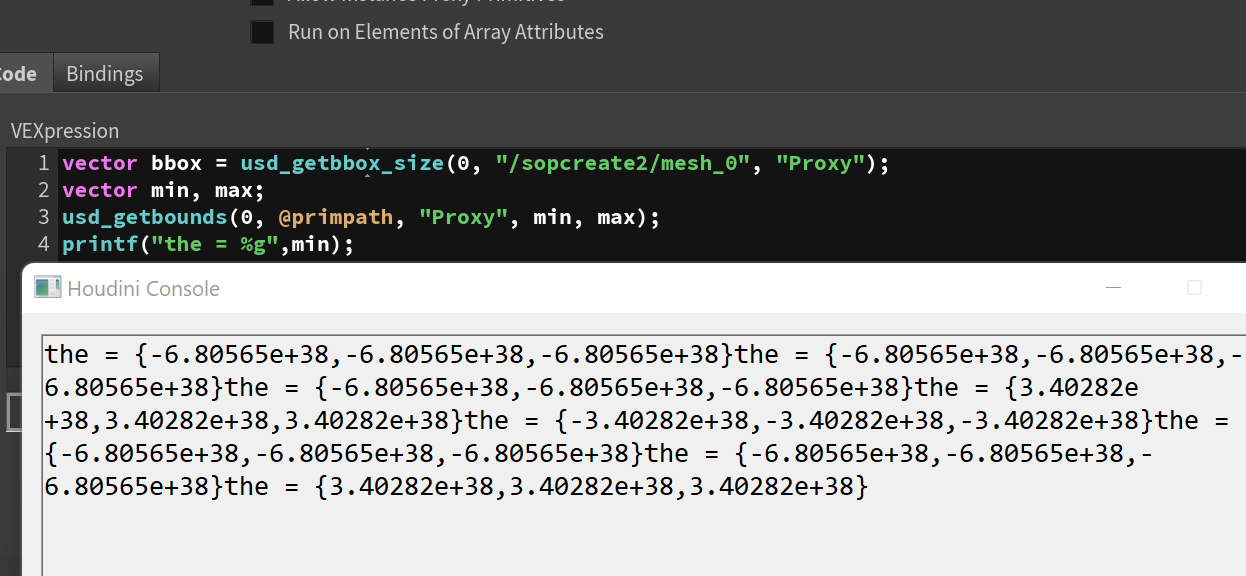

not resolved here, same issue.
opened your .hip file, changed it to "Proxy" and still get same error. Was there something else you set to make it work?
I get same error with all the usd bbox functions
Edited by GrahamDClark - March 24, 2023 01:27:41
Screenshot 2023-03-24 012703.png (77.7 KB)
Yay! I'm certified! https://media.sidefx.com/uploads/accounts/badges/certified_instructor_badge_AkLiM3h.svg [media.sidefx.com]
4560 posts
The purpose name for proxy purpose is "proxy", not "Proxy". Also, make sure your mesh is in fact proxy purpose. If it doesn't have an explicit purpose set, use "default" as the purpose string.
283 posts
Thank you Mark, default works.
