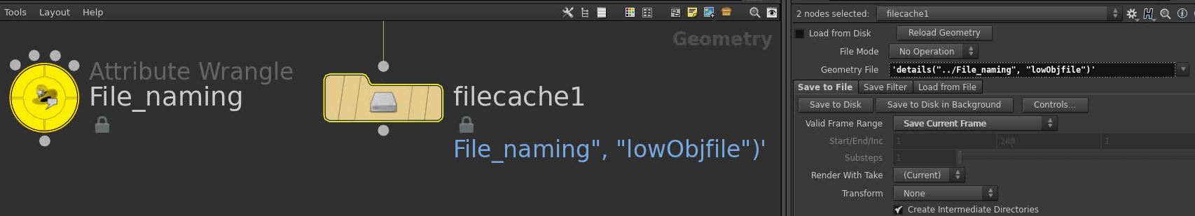

I ended up making a Detail Wrangle that makes the full file path (with version, name, extention). And its outputing 2 paths since I need to save 2 files (.obj and .ass (arnold proxy)). The paths are perfect but I'm having trouble using those strings. What am I doing wrong?
-Olivier
1193 posts
AHH!!
I was using ' instead of `
So this is what I needed to use:
`details("../File_naming", "lowObjfile")`
