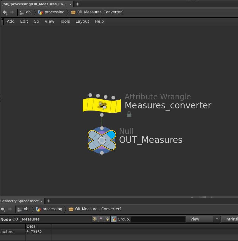

I was making a simple asset that converts feets and inches to meters. I'm getting the result as a detail attribute. How can I get that value to be displayed inside the parameters panel?

Thanks for the info but as you can see, I have no idea what I'm doin'...
I'm not entirely sure either what it is you want to achieve , but following my guess... that label parameter, label 1 entry has to be between tilde characters `detail("../Measure_converter",etc...)` for it work. otherwise it won't display correctly.
1184 posts
Ah, I forgot about that!
Now I'm getting the label to show up but the value is always "0" even if my detail value is 0.73152. Not sure what I'm doing wrong...
