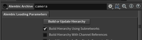

I need to execute the effect of a button press for the following
Build or Update Hierarchy
How can I achieve that in hython ?

Answering my own question
camera_geo.parm("buildHierarchy").pressButton()
