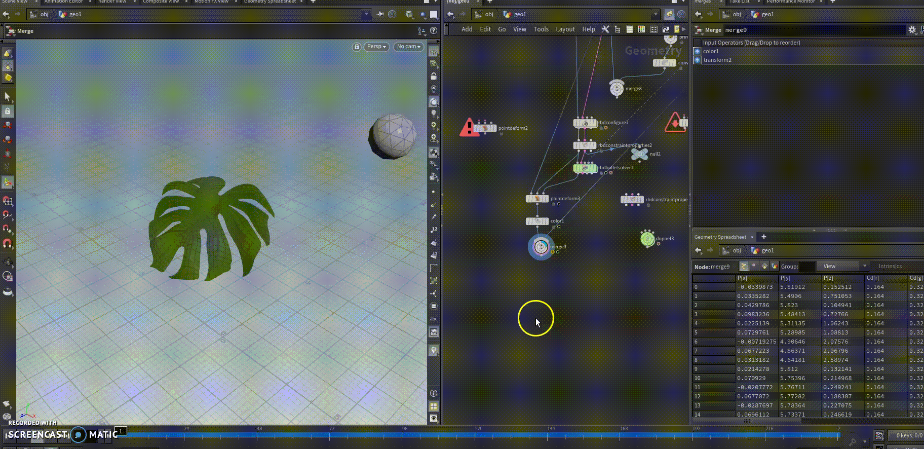

ArvanThanks Avran, this was helpful, scaling by 10x seems to be a value that works out well for bullet. I.ve been doing some soft bullet constraints testing lately (shown in gif images) and had to go up with scale and had similar issues with the vellum solver.
