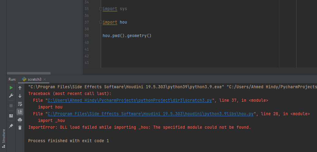

I keep getting this error
- Matthew05
- 94 posts
- Joined: April 2011
Hi AhmedHindy
I had the same issue. If you are using python3.7 or more recent in Windows, it's more likely because of the way python loads dll. Before 3.7, adding the $HFS/bin folder to the path was good., but the path variable is not used anymore. Instead, you must use this:
Here is the explaination:
python load dll failed [bugs.python.org]
import os os.add_dll_directory("houdini_install/bin") import hou

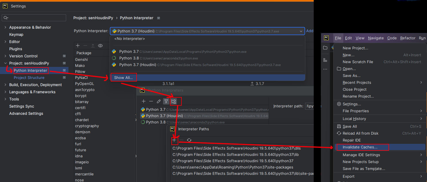

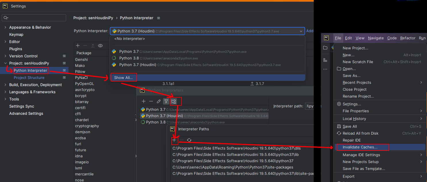

these are my personal notes with houdini/python/pycharm. hopefully they're legible. hah.
/*how to get houdini to use python3?*/
well, you need to download a python3 build. for example, on the daily builds page, theres a tab just for python 3 builds. if you dont grab one of those, youll still be in py27 (daily builds page is bookmarked in the 7pimps/houdini bookmarks)
/*how to get houdini python working with pycharm*/
1 : new project->existingInterpreter->systemInterpreter->C:\Program Files\Side Effects Software\Houdini 19.5.605\houdini\python3.7libs
2 : settings->project senBlah->python interpretor->click on path dropdown and at bottom is a SHOW ALL button
2a : in new popup click on folder icon
2b : click on + button and add this dir : C:\Program Files\Side Effects Software\Houdini 19.5.605\houdini\python3.7libs
3 : help->editcustomproperties->paste this : idea.max.intellisense.filesize=3000
4 : run File->InvalidateCaches->Restart
