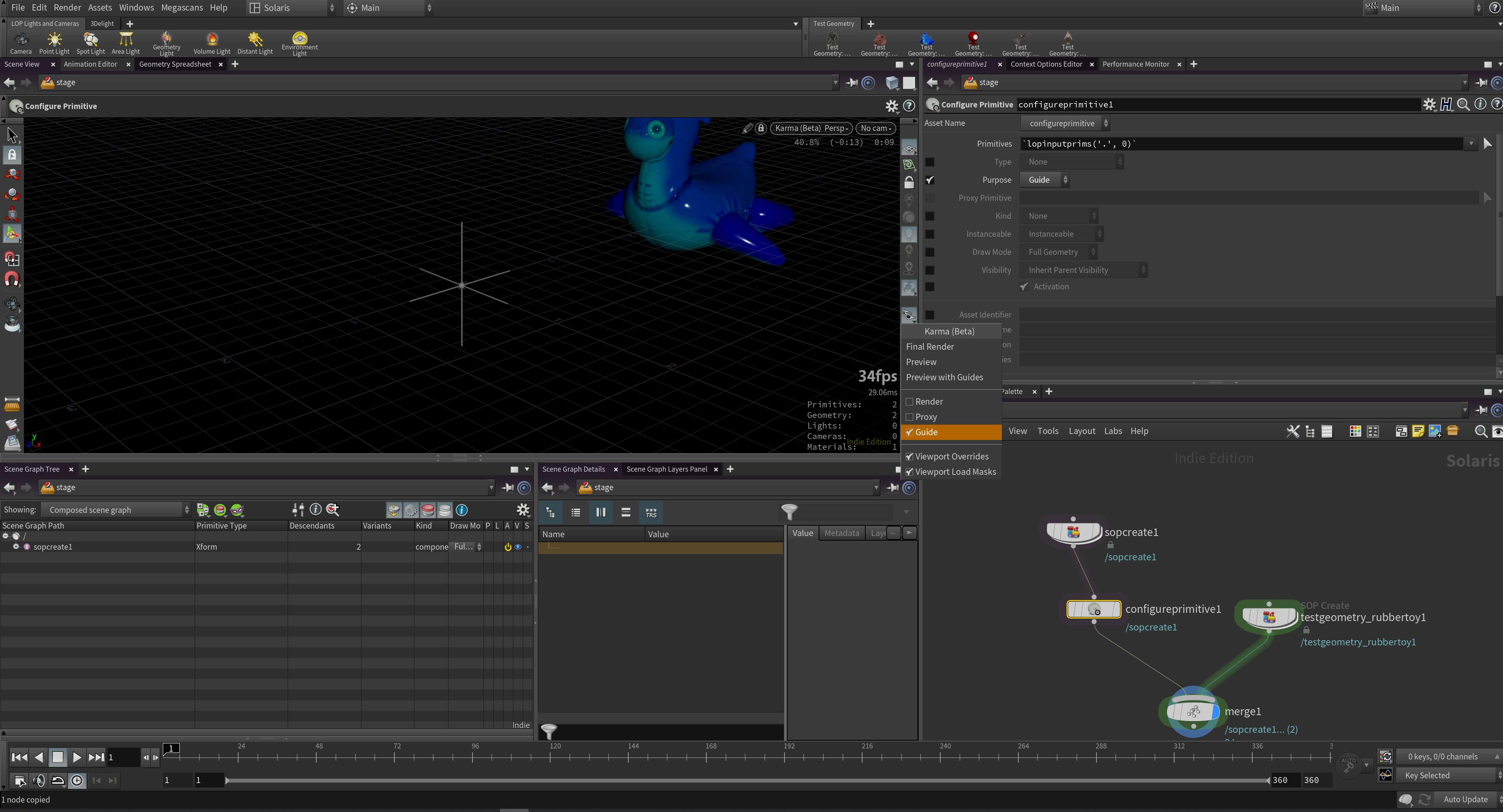

I want to create an ICON with curves like the Null Sop. They are not in the final renderer but display in the viewer.
114 posts
Joined: July 2019
You can use SOPCreate node with Control node inside, unpack the geo ether in sop or in SOP import settings (Primitive Definition - Packed primitive - Unpack) and then hide it from render by setting Purpose = Proxy/Guide token through Configure Primitive LOP.

The proxy geo is still being rendered if switching to karma.
I want it like the light icon that keeps as OGL wireframe even in karma delegate.
114 posts
Joined: July 2019
It seems those ogl wireframe guides are pre-built by devs for different primitive types under the hood of solaris.
Edited by FaitelTech - Oct. 21, 2021 10:52:17
114 posts
Joined: July 2019
Regarding visibility you need to enable/disable guides in display settings
Edited by FaitelTech - Oct. 21, 2021 10:51:51
