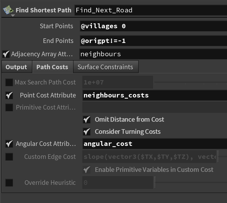

There is one parameter that can be used to assign a cost to path curvature:
This applies the value of the Angular Cost attribute multiplied by the angle turned in degrees at each point. Using this will take us a little further, but not all the way. It won't help in the situation in the first screenshot, as the value for the bridge in all cases must be much higher than that of the curvature (or we would get bridges all over the terrain).
One possible approach might be to assign a uniform value to the angular_cost attribute to cater for all normal road points and a considerably higher value for bridges and tunnels. This would take us some way further, but again not all the way as it still would allow for extremely sharp angles if there is no alternative path.
The only solution to this problem I see is to handle this like all other costs: to create a cost function that will return INF (1e1000) for paths that never should be possible. The Find Shortest Path node is designed to handle this type of cost, as it won't consider paths or nodes with INF costs.
To do this, the Custom Edge Cost parameter would be used to call an external function that would accept three path points: the previous, the current, and the next under consideration. It would calculate the XZ angle between these points and return 1e1000 for impossible paths. This is straightforward to implement.
