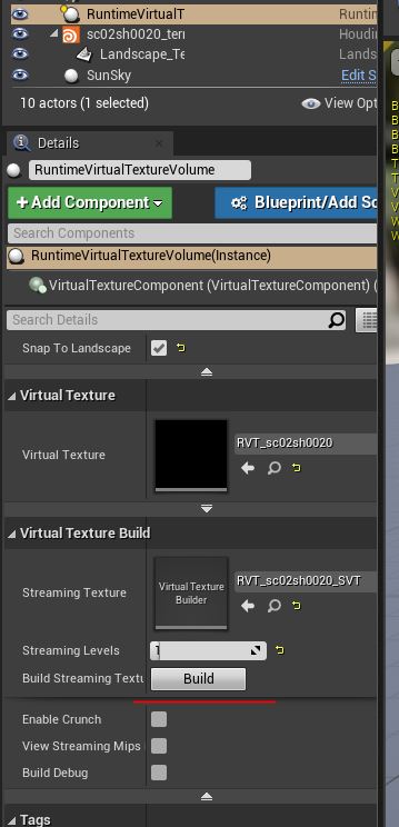

is it possible to generate virtual textures in Unreal Engine 4.27 from Houdini HDA Terrains? I can create the nodes, but I am not sure the Build button is doing anything.

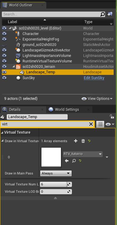

Ok, I managed to get virtual textures working on an hda heightfield landscape hda in Unreal. See image. Once piece of the puzzle solved.
