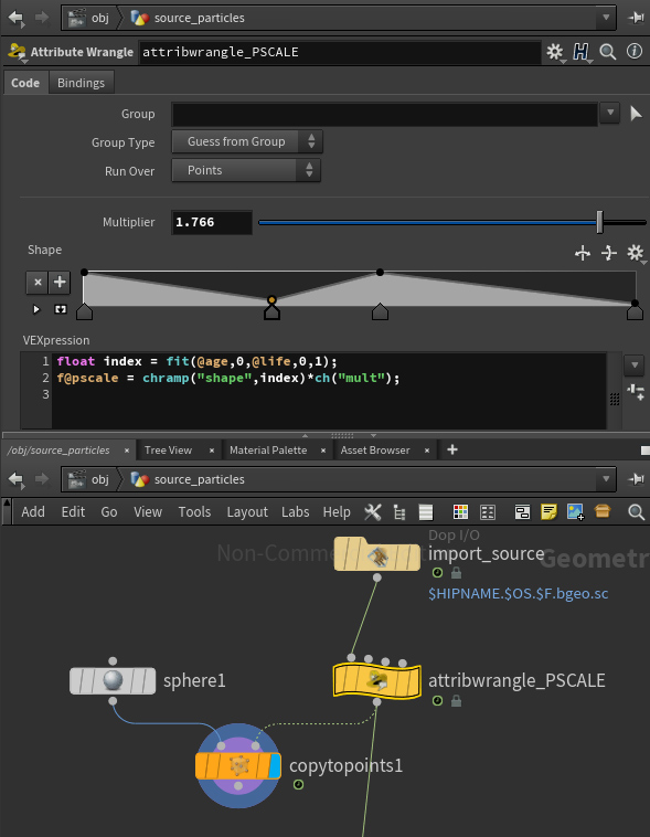

A common setup is to normalize age over life. Then you have a percentage (i.e. 0-1) that you can route to a control ramp. The left side of the ramp represents birth, and the right side represents death. This way you can shape growth throughout the life of the particle.

Pops internally generates a normalized age attribute, that is not visible on the geometry
spreadsheet, @nage. So you can use float index = @nage in this case also.

It is working. It's just that your particles life has been reached, and the fit you are using is clamping
everything. If you up that fit to 10 or so, you'll see the attribute create is working.
Your simulation starts at frame 1, so by frame 120 a lot of your particles have reached their full age.
But I would stop using attribute create, as it's single threaded. Just scrubbing the timeline using
a wrangle is about 20x faster compared to the attribute create. That SOP is verrry old, and the use of
$ type variables is also verrry old, you don't want to use this method at all.
Instead, just use a wrangle after your point VOP,
f@pscale = @Cd.r * 0.02
You point VOP mapping vel to Cd doesn't need a vectofloat, the length VOP is already spitting out a float value btw.
