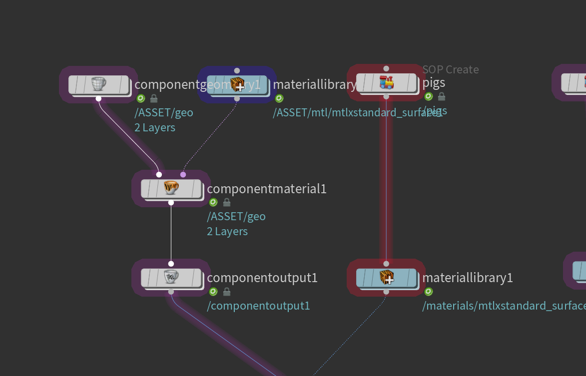

As for the holes in my geo:
I also attached a render. Is it normal to get holes at lower qualities? I tried my best to keep the scenes as simple as possible, even tried Fuse nodes, but unless I crank the dicing quality I always have some little slices of holes in the geometry. If this is just how dicing and subd in Karma works, that is fine. I just don't know if dicing at lower quality is supposed to produce water tight meshes. I'd love to hear an answer from SideFX about this
I attached a file where I applied subd on a cube and the resulting render produces tiny holes in my mesh that mess up the alpha. Again, better quality will remove it but also increase render time quite a bit.
And finally I was able to find out why the render would recalculate the subdivision phase. When I use the component builder, the material gets merged into the layer. I don't know which step exactly but something in the component builder makes it so that on every material change, it also has to recalculate the subd. If I just apply the material with a materiallibrary node, this is not happening! Not sure yet if this is a bug or feature.
Edited by beatreichenbach - March 24, 2022 00:09:51
