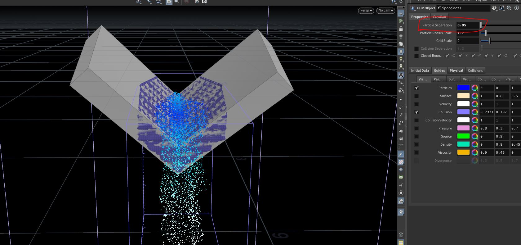

Your voxel size is so large that it reacts with the collagen before it hits
It is created by reducing particle separation

This is due to the concept of fluid function in Houdini
In Houdini, speed, collission, etc. are calculated by volume and then transferred to the particle, which is why this happens.
viscosity works almost like vdb smooth. And as the body softens, the function of the collission is disrupted.
