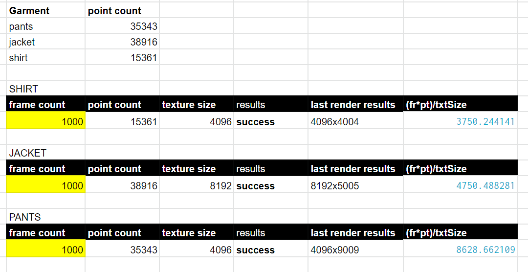

I have been multiplying the frame count by the point count and dividing by the texture size (frame_count*point_count)/texture_sizeand it seems if that number is below 9000, it completes successfully. But I'm grasping at straws here through trial and error.

UPDATE. It seems to work.
I used this metric of keeping the calculated number under 9000 (frame_count * point_count)/texture_sizeand it seems to be working for all of my costume pieces. I kept them all at 1000 frames so I can line them up in the sequencer in Unreal.
