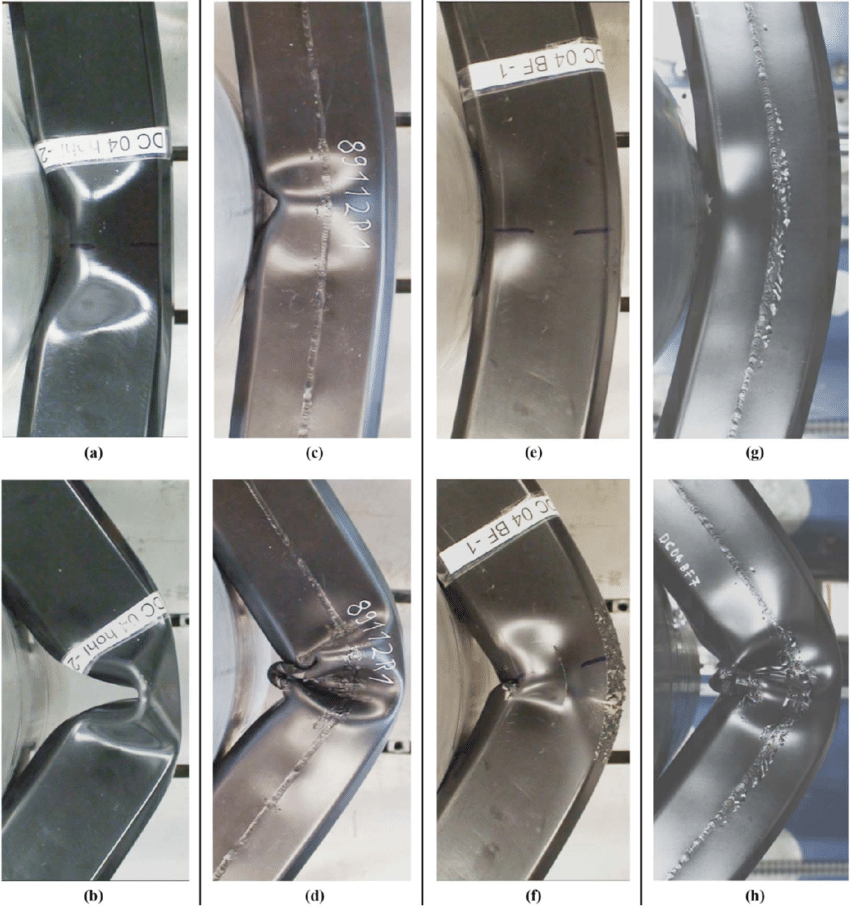

Thank you for getting back! Find attached an example .hip + geo. It is a different mesh (from STEP vs IGS) and lower-res for the sake of bandwith but the problem stays the same. I want to get the overall transformation of the beams from the difference of the two point sets. However, I need the overall "integrity" of the beams to stay intact. Meaning that if they bend, they throw folds and wrinkles like in the photo attached. I couldn't make it work with vellum, maybe also because it's to resource intensive. The Drop Off / Weighting of the Bone Capture Proximity Node come's very close to what I think would be needed (especially together with a Tension Map like: here [www.sidefx.com]. But I can't make it work without the whole bone structure. Is it possible to construct something like this with the "skeleton" of the point?
Or is there maybe a totally different, better approach? I'm a little desperate and would v much appreciate any hints / tips!
