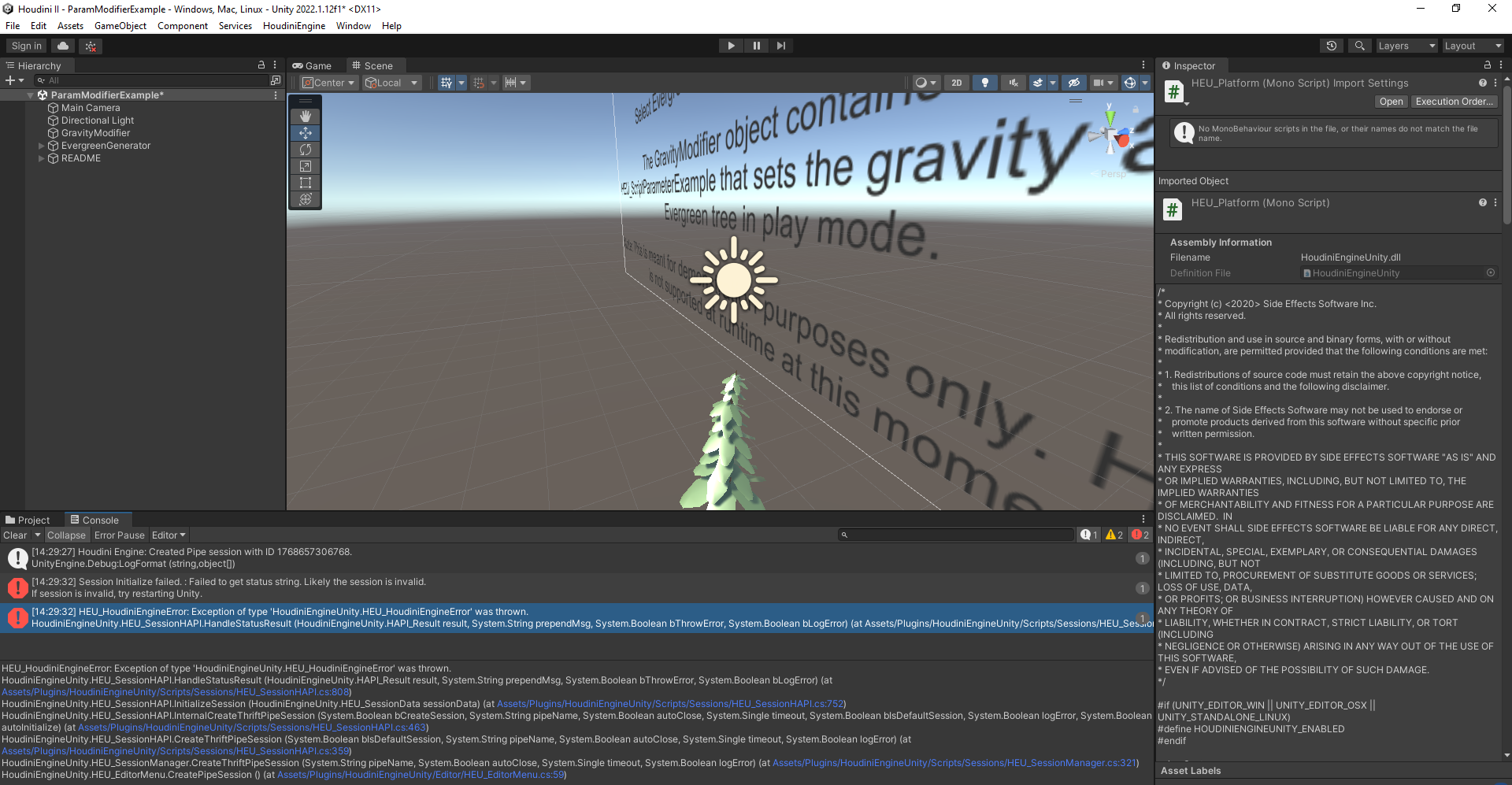

I can not get anything working wit the Houdini Engine for Unity plugin. I get the following errors:
Session Initialize failed. : Failed to get status string. Likely the session is invalid. and
HEU_HoudiniEngineError: Exception of type 'HoudiniEngineUnity.HEU_HoudiniEngineError' was thrown. What am I doing wrong? Using Unity 2022.1.12f1 and Houdini 19.5.303
Any help would be great!
Thanks
Houdini II - ParamModifierExample - Windows, Mac, Linux - Unity 2022.1.12f1_ _DX11_ 8_8_2022 2_35_53 PM.png (470.7 KB)

Hi, I have the same problem here. Did you figure out what caused it? Kjetil

Hi, I had the same problem with Houdini vesrion 19.5.403. I tried old version, especially 17.5.391 and it works fine. Before creating a new session in Unity, close all previous sessions.
