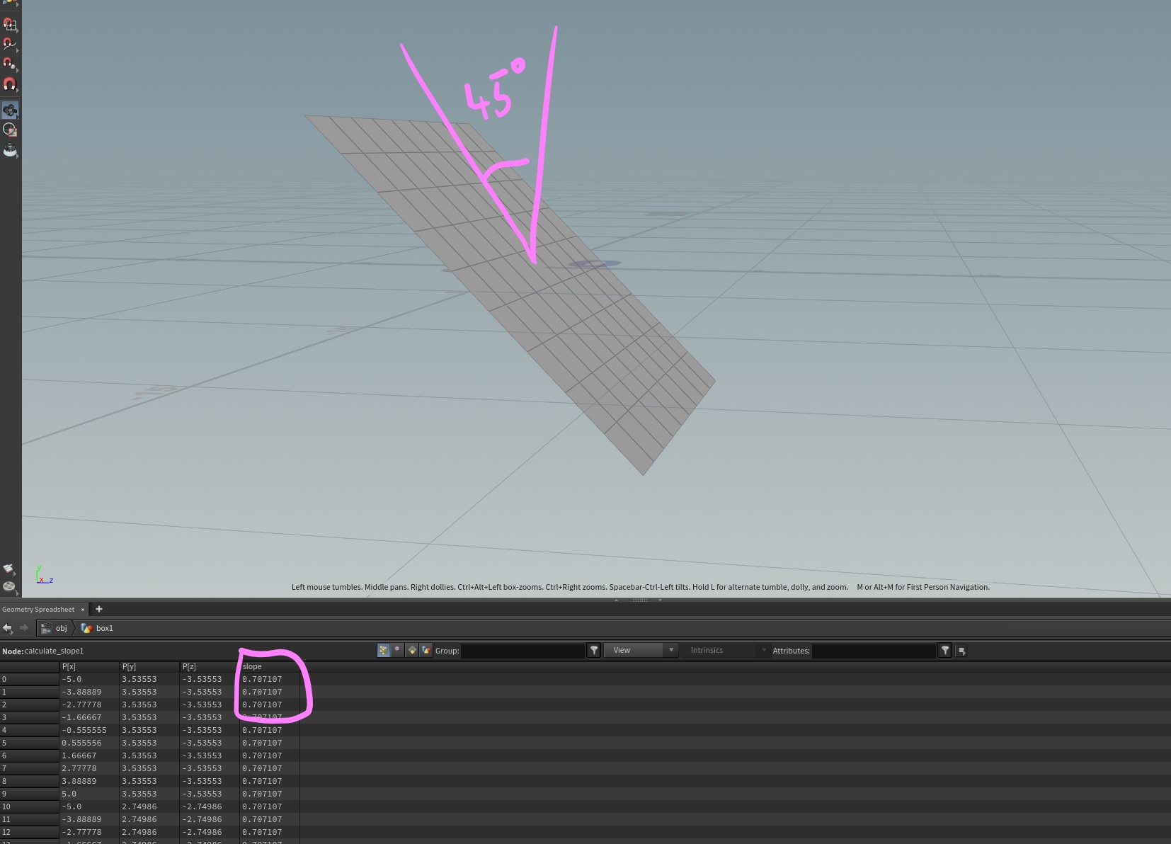

Scatter by slope:
I'm trying to provide a max/min value (in degrees) that will only scatter points on a surface within that range. Ex: 0 - 45. I've created a terrain and passed it through the LabsCalculateSlope node. When messing around with it, it gives me values I wasn't expecting. I would guess that a grid rotated 45 degrees would give a slope of .5 but it gives .707 instead. My temp solution is remapping the values from what it gives to what I expected and it sort of works but it's still pretty inaccurate. I'm sure there is a mathematical solution or something I just don't understand!
The second question is similar... I'd like to scatter objects on a surface and align them with the normal of the surface, but provide a maximum deviation from "up" in degrees. ex: a point lands on a surface that is at a 5 degree angle but the max is set to 3 so it would be oriented at 3 degrees rather than 5.

You can do this using a Point Wrangle:
float GetAngleBetweenVectors ( vector v0; vector v1 )
    vector v0n = normalize ( v0 );
    vector v1n = normalize ( v1 );
    return degrees ( atan2 ( length ( cross ( v0n, v1n ) ), dot ( v0n, v1n ) ) );
vector up = { 0, 1, 0 };
@angle = GetAngleBetweenVectors ( @N, up );
float maxangle = radians ( ch("maxangle") );
if ( @angle > maxangle )
    matrix3 m = ident ( );
    vector z = normalize ( cross ( up, normalize ( @N ) ) );
    rotate ( m, maxangle, z );
    @N = up * m;
