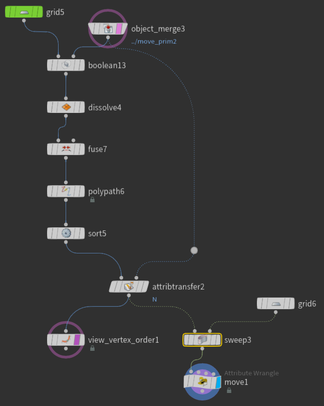

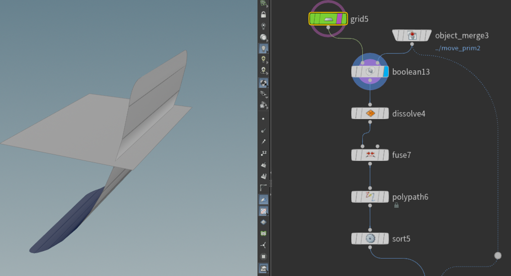

Hi Tamte! Thank you for the reply. I tried your solution, however, it seems that the problem still occurs. Perhaps, it is better for me to explain on what I want to achieve first. So, what I did here is that I used Boolean SOP on a given geometry (object_merge3) with a Grid. I used the abseams from the boolean operation to get the polyline on which later I would use the Sweep SOP to create a box. However, if I move the grid position, sometimes the vertex order changes. That is why I need a consistent vertex order so that I do not need to keep manually reverse the cross sections from the sweep node.
