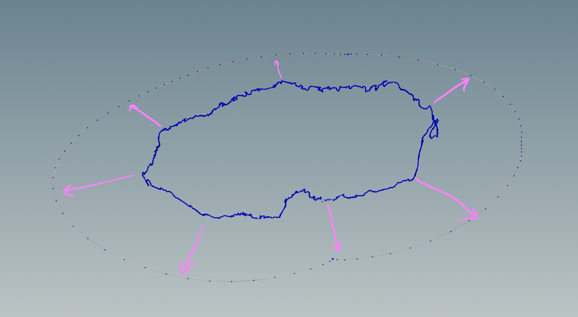

I have a question about curves. I have two curves with different numbers of points and both have a @curveu. I'm trying to move all of the points of the first curve to the corresponding position along the second curve based on @curveu. Does anyone have thoughts on how to approach that?

You can use primuv VEX function inside a Point Wrangle SOP where the second input is the reference curve to move the input points onto:
@P = primuv ( 1, "P", @primnum, @curveu );
