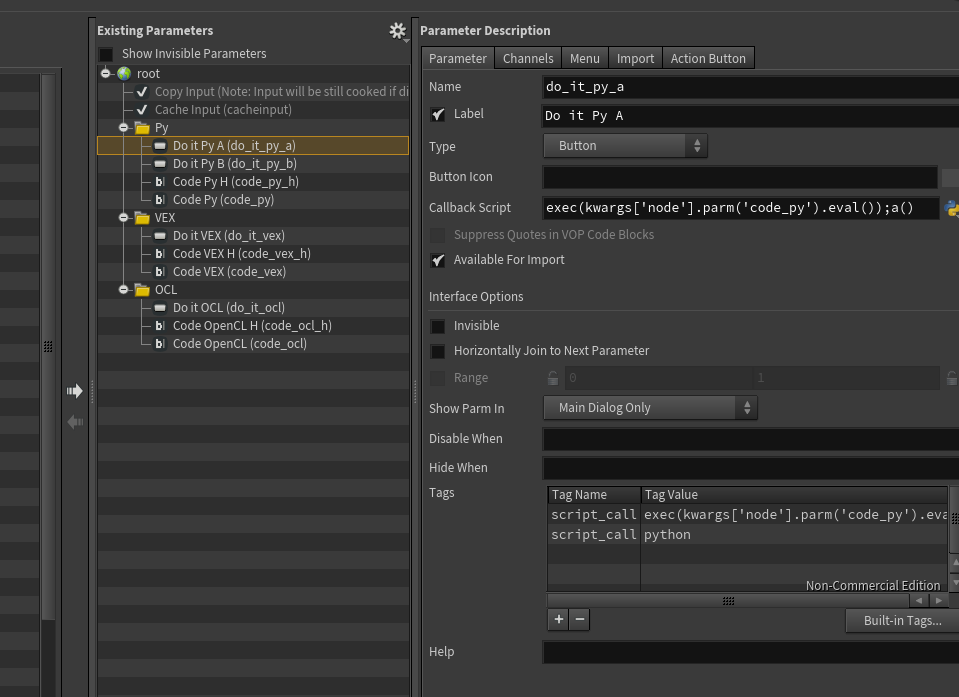

Callback script
exec(kwargs.parm('code_py').eval());a()
Multi-line String
content:
def a():
    print('Yes!')
244 posts

If you just want one or a couple of run buttons and then some python code it is possible to simply attach this to a null. Probably you could attach it to any subnetwork or HDA as well (I've not really been trying this though).
