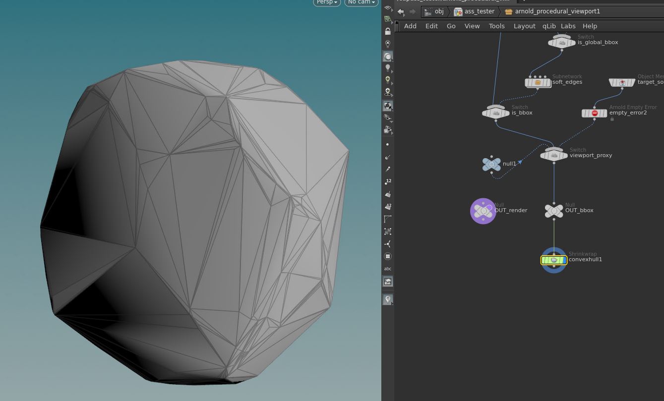

Alright, found it!
If you create an Arnold Procedural with your .ass geometry path in it, you simply dive inside that node and inside the arnold_procedural_viewport1 hda. Inside, you can access the points. I used a convex hull and it works! I'll be able to create my low res from those points.
-Olivier
