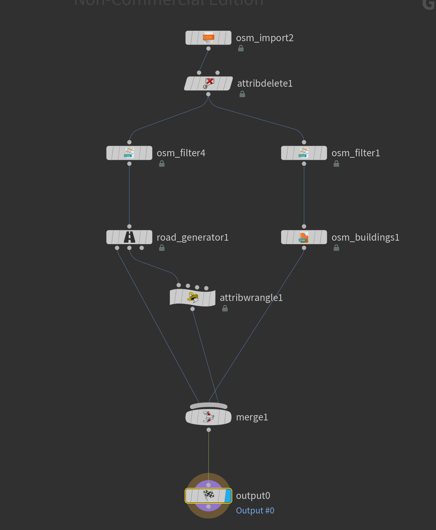

This is what the graph looks like, which is directly from the demo.
The only thing I added is the `attribwrangle` node which simply does this:
(Sets `i@unreal_output_curve = 1;` on the curve. (Without this, I get no splines at all.)

Ok, somewhat answering my own question, now that I understand better how Houdini works...
Looking inside the Road Generator itself, I can see what happens to the straight lines. They seem to get converted to dots, and then the road tiles are placed on those dots. So the lines are, in fact, gone.
I thought maybe I could just pass in the original lines and use those as splines, but they don't really match up with the road after all the processing that was done to them.
So I guess the answer here is to edit the Road Generator network to output proper lines that go along the road.
