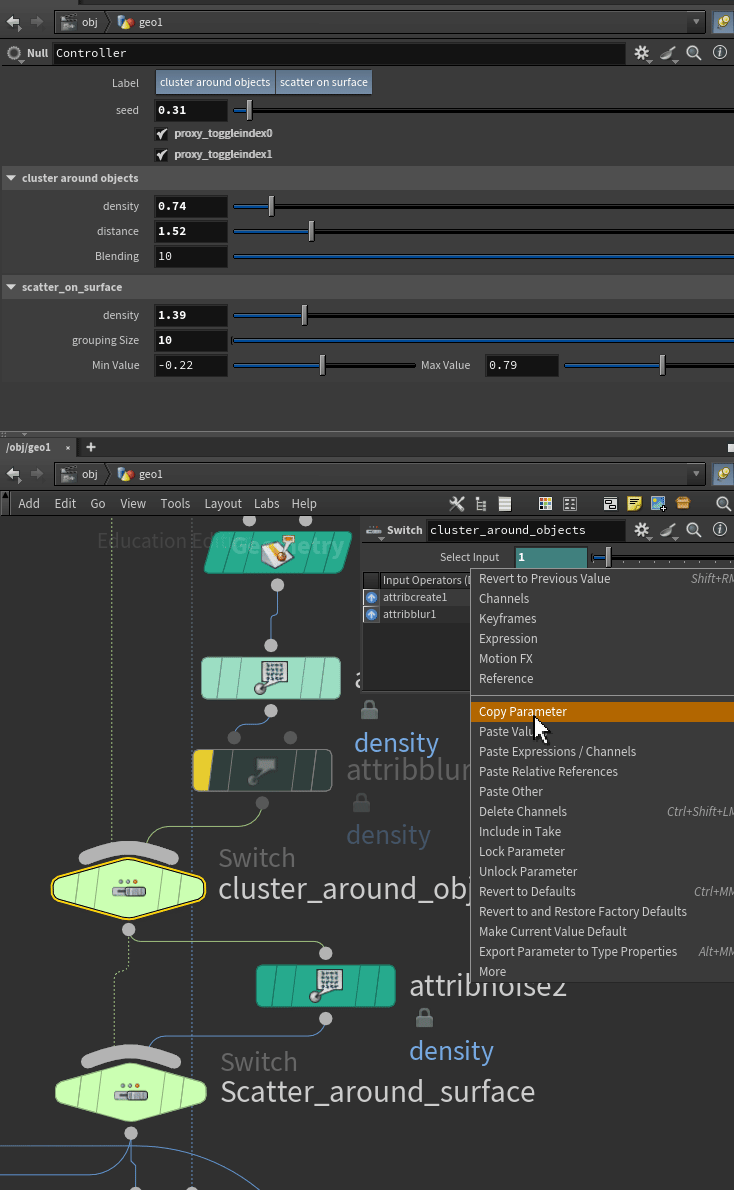

hmm. how would you use this in a gui's HIDE WHEN field ?
this doesn't appear to work :
{ bittest(cow,0) == 1 }
Joined: Sept. 2023
indigosm
5 years later and i ran into the same issue. based on my readings, It seems like the field just doesn't support bittest()function.I solved it by creating one with a proxy parameter. hope it helps! (and anyone who came across this in the future)
here's a gif on how I did it:
https://i.imgur.com/Ic0j68Q.gif [i.imgur.com]
Edited by Irene_Howard - April 16, 2025 19:36:19
