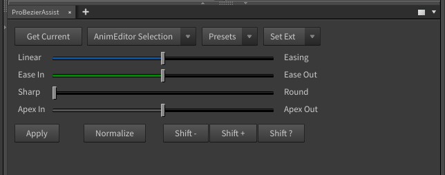

Here is nice highlevel utility I wrote to control keyframes and handles, great for getting nice space- and temporally smooth easings.
The video is a bit older then current UI but the same principle remains
Part of my free and open toolkit: ttps://bitbucket.org/jcdeblok/jdb_houdinitoolkit/src/master/
Edited by Jonathan de Blok - May 23, 2023 09:52:43
Screenshot 2023-05-23 154823.jpg (23.3 KB)
