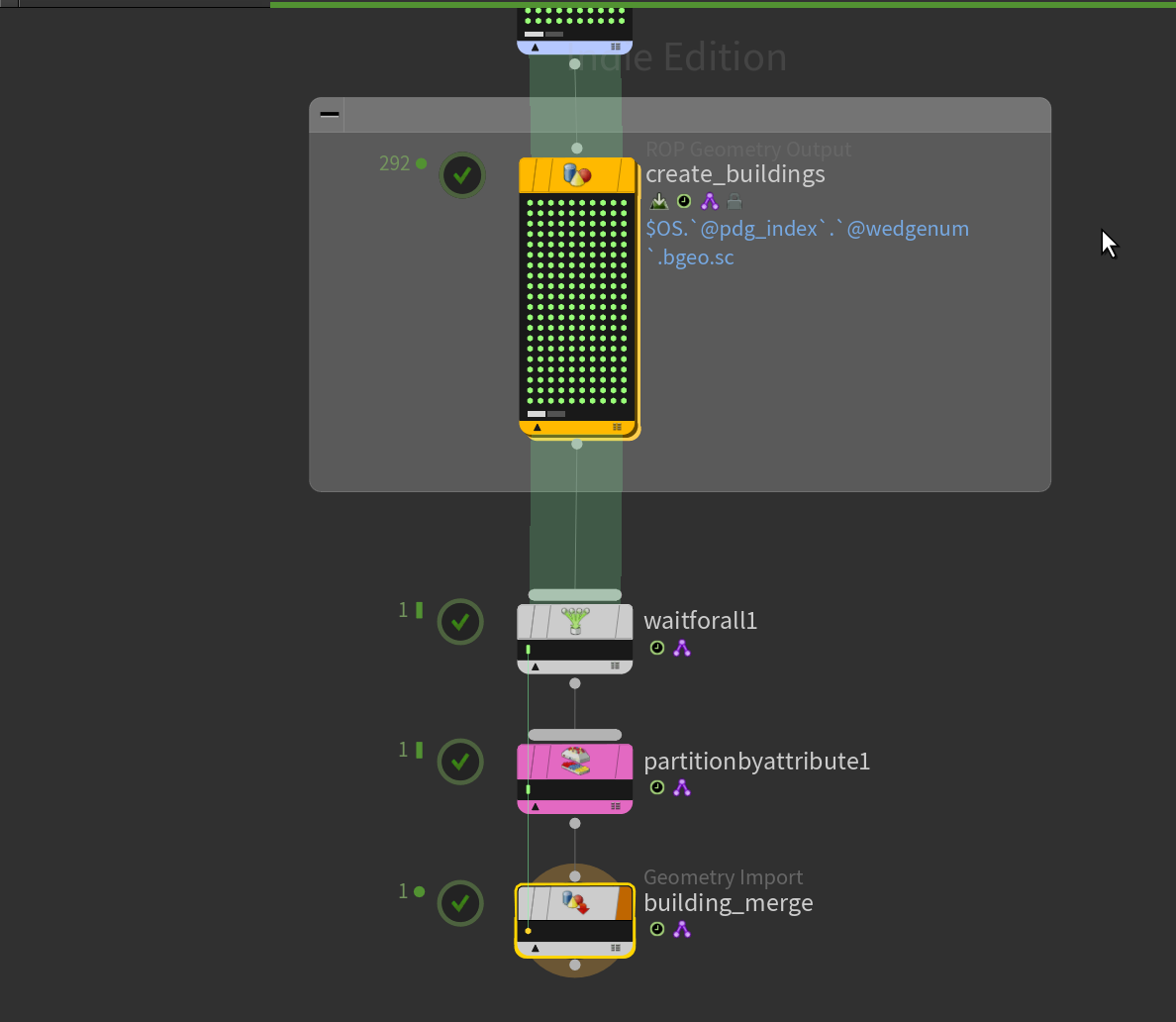

I get stuck in part 7: https://www.youtube.com/watch?v=rS4nTqgy4s8&t=7s [www.youtube.com]
- After the Partition@ Node, I only get 1 result, but the wedge should create 4 variations.
- And within the HDA (subnet), I get this error: Error: Unable to evaluate expression (Bad data type for function or operation (/obj/street_grid/subnet1/tz))..
Cooking works nevertheless.

Step 7 says to replace the wait for all with the partion by attribute. Then you will get four cities.
