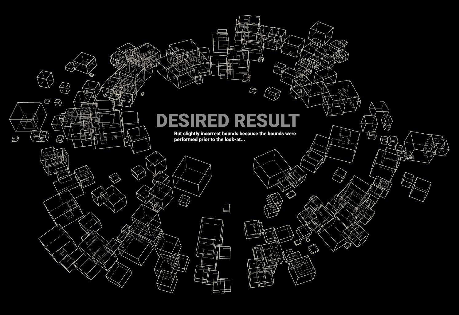

End result of the total bounding boxes needs to (essentially) look like the attached image.

13 posts
Joined: May 2014
Here's a comparison of the end result. No up vector defined (first option) vs defining the up vector (second option).
I'll keep digging; thanks for the tips.
