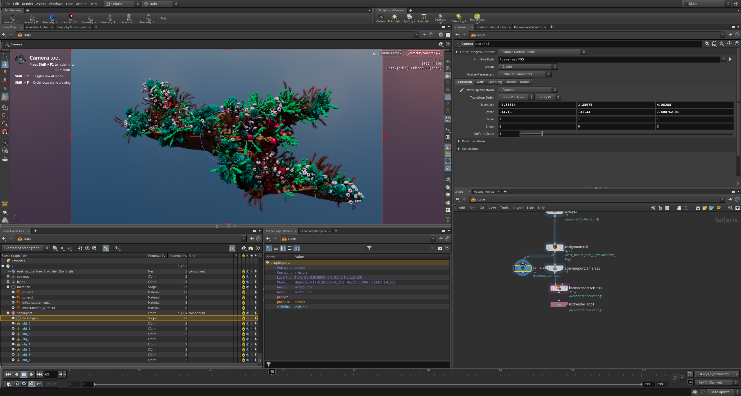

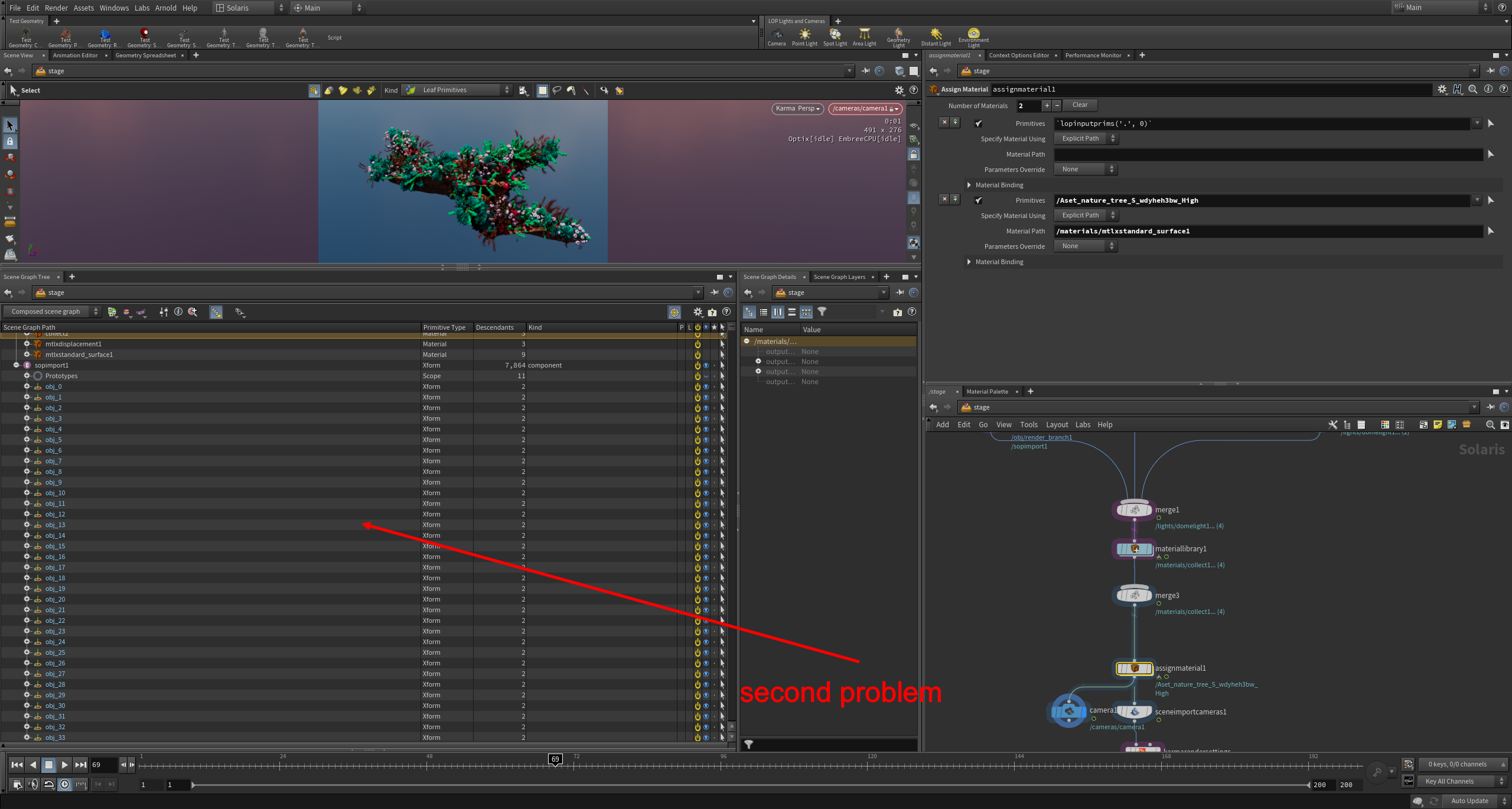

Hello! There are a couple of problems that I encounter when working in solaris. The first problem with importing the camera from the obj context is that when I use Sceneimportcameras the displayed image is blurry, although in another project I also used the CineMotion asset and everything worked correctly, what could be the problem who knows ??? I tried both on the CPU and on the XPU I get the same thing (I attach the screen). Although if you install the camera directly from solaris, the image immediately becomes clear. The second problem is with importing geometry, I get a huge number of elements that I can’t figure out how to group in order to assign material to a group, and not assign each element individually. In total, you need to make somehow 5 groups to assign the material. I can upload the project file if needed. Thank you in advance.

Regarding the blurry image:
* when we create a camera directly in Solaris, we use an f-stop value of 0 by default (effectively: no depth-of-field effect)
* when we create a camera in /obj, we use an f-stop value of 5.6 by default
SceneImport will use whatever f-stop value it finds on an /obj camera when creating a Solaris camera, which is why I expect you see a difference.
Regarding the second problem, I'm happy to look at a project file.

Thanks a lot for the help, it really helped, just needed to figure out the f-stop value. Regarding the second problem, I solved it this way, in the sop import node I moved to the Primitive Definition -> packed Primitive -> Create Point instancer tab (because I realized that the geometry was packed in the SOP context when working with the Copy to POints node, Pack was selected and Instance), I believe that this was exactly the snag, after this manipulation everything was decided. But now there is another problem, I decided to add mountains and sand, on which I want to put the tree itself, which is on the first screen, respectively, now the question arises, it will be right to do all these manipulations using obj, that is, by pulling the geometry through sop import in solaris and make a landscape change, or download it directly as a subnet and build a network via usd. By the way, do you know how I can add sky to my scene??? So how do regular HDRIs maps not show up on render?

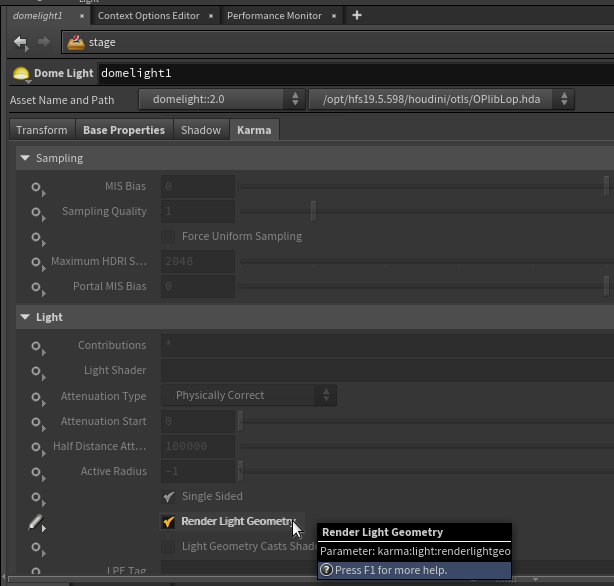

1. I want my HDRIs map, which I loaded into domlight lighting, to be displayed in solaris when rendered in karma, and not be a black screen.

For the HDR, you can setup your /obj light like this:
SceneImport will respect this setting and setup the Solaris light appropriately.
If you're creating the light directing in /stage, the parameter can be found here:
I'll have a look at your scene file and try to reply to points 2&3 later.

Thank you very much, it helped me a lot ..

If you have a single mesh, you need to create GeomSubsets for the different faces in the mesh and assign the shaders at this level. If you use SceneImport to bring in the geometry, you should see what the result looks like in terms of scenegraph structure.

To be honest, I don't quite understand how to do it... I created a new scene for an example and loaded the .fbx format tree there. Further, through the SOP, the import was able to load the groups one by one and merge them into one, which led to a normal result, but I understand that this is not correct. I'm trying to understand, if I create a subnetwork, then inside it I need to load the geometry through sop import or through sceneimport and then do something .... I can't understand (((

Here's a modified version of your scene that shows solutions both using Scene Import and SOP Import. For SOP Import, you can set a "Partition Attribute".

Wow!! Thank you very much, low bow to the ground! Now I understand how to do it and where my mistakes were!!! It's nice to have people willing to help!
