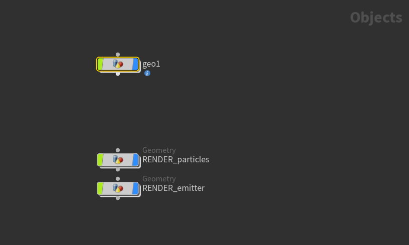

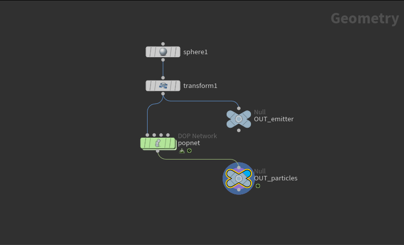

That seems needlessly complicated, you do not want to have to change flags before starting a render, that's a good recipe for mistakes. The way I would do it would be to create nulls on the side of your particle emission setup, one for the emitter, and one for the particles.
Then at Object level, create two new render objects. These objects only contain an Object Merge node that point to each of your two nulls. Tou can set the material at Object level as well. These will be the render objects.
Then create two Mantra nodes. One will render the particles with the emitter as a matte object, and the second one will render the emitter with the particles as phantom objects, so they don't occlude the emitter, but still cast shadows and produce reflections.
