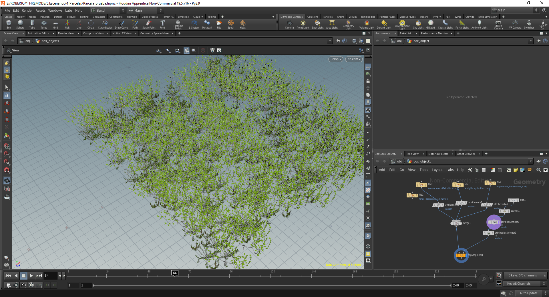

Hello again, I am going to explain in detail what I intend to get which is to create a scenario simulating forest plots with 3D models.
First of all I have the data of the 3D models of trees and shrubs with their position in a csv, with the help of the Table Import node I have been able to import the table to Houdini (image 1) and with the VEX code "@P.x = f@X; @P.z = f@Y;" and the point wrangle node I have put the positions of each model (in total there are 486 3D models in a 30x30 plot) in their corresponding position (image 2). But I have not been able to import each model of the "Species" column of the 486 in its respective position, I imagine that it will be using the VEX programming language but I am a beginner in Houdini and I have never used that language before.
On the other hand, I have made a test with various tutorials with 500 random points and I have managed to import three 3D models of species as an example (image 3 and 4) using the copy to points node as shown in the image.
Finally what I would like to get is that the 3D models of each model in the column "Species" is placed in their respective position X and Y automatically either using the language VEX or python but the problem is that I am a beginner in Houdini, VEX and python, hahaha I'm learning sorry.
