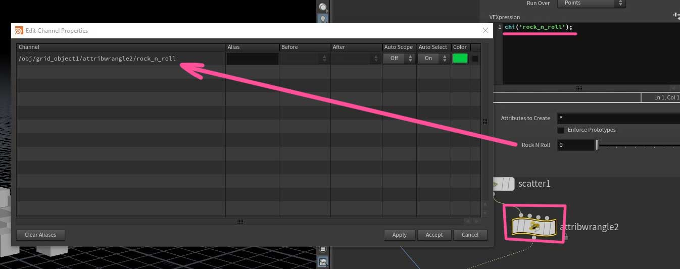

I can't figure out what it is. Fields for entering values (marked in the picture).
In some tutorials this is called a parameter, in others it is called a channel, and in others it is called attribute components.
What is it really? If it is a channel, where does it exist before it appears in the channel list? And what then is the difference between a channel and a parameter?

Those are two words used to describe the same thing. Inside HOM, Houdini's python implementation, channels are referred to a "Parms" short for parameters.
Inside the VEX coding context, however, you access "channels" from the node by referencing their parameter names.
Why use one over the other?
Python is the only code that can write to a parameter. VEX can only read "channel" values.

Thank you very much for your answer and time! I appreciate it very much!
Let me try to describe the process as I understood from your answer. Please correct me if this is not the case.
A value input field (like the one in the picture above) can only be created by Python. And if on VEX we create a channel with the function ...ch(...), then VEX again turns to the internal Python shell so that it creates a parameter with an input field.
Further in this PARAMETER we can specify any data and Python creates attribute values from them.
The “channel” entity is needed only so that VEX can communicate with it.
And if I see “Delete Channel” in the context menu, then all information added through VEX (or simple expressions) will be deleted. Here I just don’t understand where exactly the information is being deleted from, apparently it’s some kind of data array that I don’t know anything about yet.
And if in the menu we see “Delete parameter...”, then a piece of Python code will be deleted and the input field will cease to exist. Accordingly, there cannot be any channels other than those that were created initially.

AndomiroslawIf you mean that the user has to use python to create the new field itself, no. One can use the 'Edit Parameter Interface' of the node to add additional parameters with input fields.
AndomiroslawActually no, the function ch() and it's varients in vex do not create a channel at all.
And if on VEX we create a channel with the function...ch(...)
It only ever 'grabs' the data from the specified parameter in it's argument.
It is the vex node itself when you press the button 'Create Spare Parameter' that it looks in your vex code for that node to see if any ch() functions exist without reference to an already existing parameter, and in those cases in which it is not, creates the new spare parameter. Now under the 'hood', I don't know if it's using Python or underlying C++ API; But again, any ch() function only ever returns the data of the specified parameter that contains the data.

...any ch() function only ever returns the data of the specified parameter that contains the data.
Hello BabaJ!) And thank you!
I think I understand what you're talking about!
However, when I try to reproduce it makes my socks fly off
In the Attribute Wrangle i create a parameter with any value that Houdini "doesn't know". And this action already causes the channel and parameter to exist (I marked this in the picture).
Maybe I'm thinking in the wrong direction...
Edited by Mirsildin - Oct. 4, 2023 11:47:34
- Mirsildin
- 8 posts
- Joined: Jan. 2022
- BabaJ
- 2182 posts
- Joined: Sept. 2015
Mirsildin
Ok, yes.
Mirsildin
What do you mean by 'already'? You created the parameter and also used the parameter to hold a value that you want. Neither the parameter or value held by the parameter could not have already existed before you created it, let alone hold a value.
If you mean you wrote in the wrangle the function itself, i.e. any form of a ch() function; Without also creating a parameter by pressing the button to do so, or creating it through the Edit Parameter Interface, or somewhere else with a Python...then that ch() function within the wrangle code window will just by default always return a value of 0 - If it doesn't see/find an actual parameter that the function is referring to( from which to 'grab' data from ). That is aside from the fact that a typical newly created parameter, like your example, without any overriding input targeting it's field or specific user defined default - will also start with a default value of 0; save too with something like a string parameter which basically starts with a 'null', and so on with all the other specific contexts of other types of parameters.
So, I don't know what your 'issue' is, i.e., what you are struggling with except maybe the relationship of the ch() function/s and the parameters they reference and the data they can contain.
Perhaps it may help to know that the behavior of the ch() function is such that it could have been written in that instead of returning a default value of 0 even if the parameter it is referring too still doesn't exist; Create a warning pop up window notifying you that you are referring to a non-existant parameter and as such cannot proceed until you 'rectify' the matter and create a parameter with said name given to the function.
