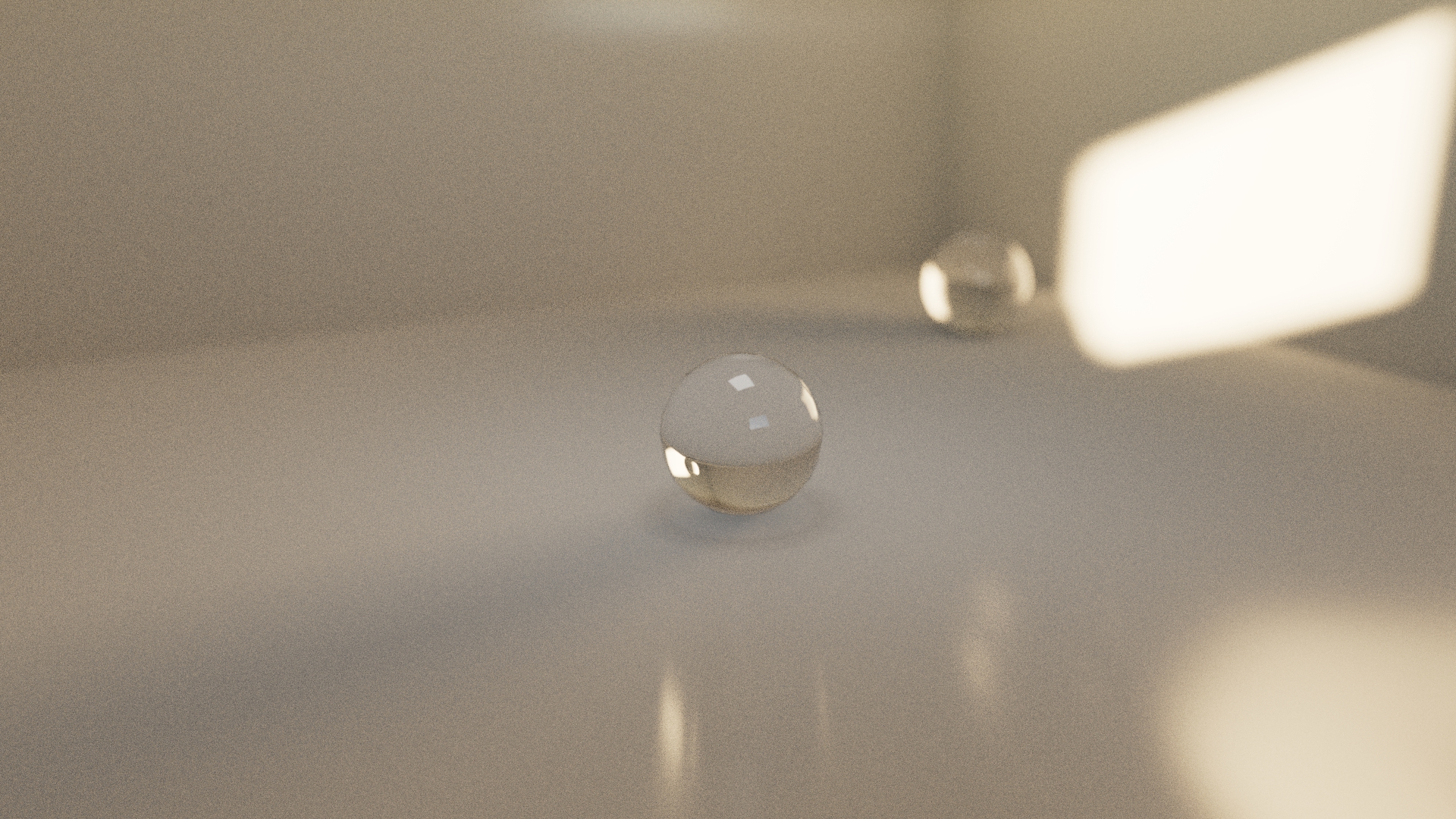

Hi Brian, here is the a file that takes 5 mins on my machine (specs below). Rendering with similar settings with redshift(a much much cleaner in terms of noise) took a little over a minute.
1. The GPU seems to be working fine (hopefully it is lol)
2. Didn't really use XPU in H19.5
System Specs:
CPU - Ryzen 3950x
GPU - RTX 3090
RAM - 64GB
Windows 11
Nvidia Studio Driver Version: 546.01
Edited by traileverse - Nov. 12, 2023 20:10:27
hou.f*ckatdskmaya().forever()
- jsmack
- 8237 posts
- Joined: Sept. 2011
traileverse
This scene is a very bad scene. It's not one I would expect to be able to render without a lot of noise or using denoisers or some indirect acceleration like photon cache. It's white glossy box being indirectly light entirely from a blown out diffuse reflection, has shallow depth of field and refractive objects. A pure brute force renderer like Karma which as no optimizations (cheats) is going to be slow to render this.
A simple scene is one that is directly lit and doesn't have light bouncing around forever off white glossy walls. like a torus or teapot something.
Edit:
The scene doesn't appear to load correctly for me. It's using materials that are using textures I don't have.
is this what you see?
Edited by jsmack - Nov. 12, 2023 20:31:21
Edit:
Yeah, I see what you're saying about the type of scene and the fact that it's a brute force renderer, I need to render indoor architecture type scenes, this is my bad stress test. I might have had unrealistic expectations about where XPU would be in comparison to redshift in terms of speed and not taking into account the fact that it is a brute force renderer. I still to learn more about using Karma but I tested with other simpler scenes and the speed just isn't what I expected. The bubble wrap scene in the content library takes nearly 30mins to render even when I turn off depth of field. I get that the transmissive material and all but is that economic? is a 4090 really twice as fast in a linear way to cut that down to 15mins?

yes, that's the image, it's just using materials from the catalogue, what was your render times on it?
- jsmack
- 8237 posts
traileverse
It took 4:30 with the settings from the scene, 512 samples.
