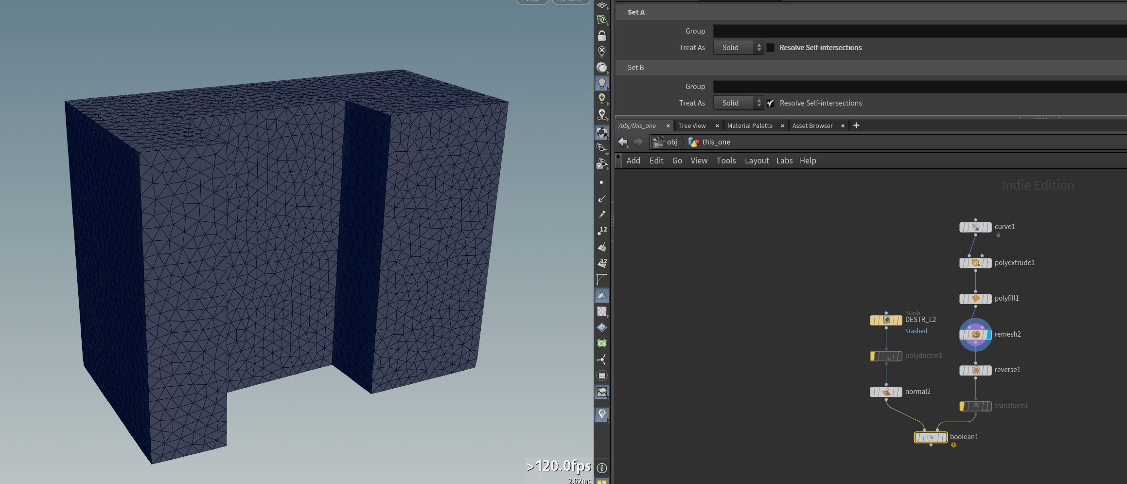

Hello, well the boolean is kinda vocal here and complains about non manifold geo (p6927-6930) in SolidA.
Boolean OP comes by default with a self-intersection option on, so each solid is first resole against himself, before the final operation. You can disable it for SolidA (Set A) as Houdini seems to have hard time validated/clean that mesh. (I would say SolidA is what I would call a garbage geo 'topology' wise :P). Once that self-intersect disable for input A, the boolean works. (And as expected the mesh B is inverted in you graph, so reactivate the reverse).
If it's a one time process using polydoctor is fine, I kinda tend to avoid it inside a procedure tho (it's a very complex operator and I remember having it 'freezing' Houdini).
