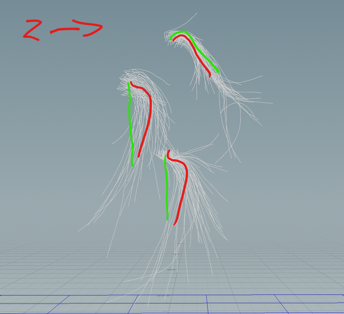

I'm getting some odd results whilst simming some tufts of hair.
I'm copying the tufts onto some scattered points and then testing with gravity. Instead of the tufts falling straight down, I get an odd push along the positove Z axis which leads to an un-natural look.
I cannot figure out what is causing this. I've tried the simplest setup I can think of and I still get the odd result. I've attached and example file and any insight would be great.

Screenshot 2024-03-20 150901.png (1.3 MB)

it's caused by wrong p@orient attribute, you can add Orient Along Curve SOP and let it compute proper p@orient along hair curves

Ah. After the copy. Of course, because the orientation wouldn't be updated. Thanks Tomas!

you can do it before, the p@orient is by default Quaternion so it would get transformed correctly for each copy
the problem is your hair curves didn't have correct orient at any point
