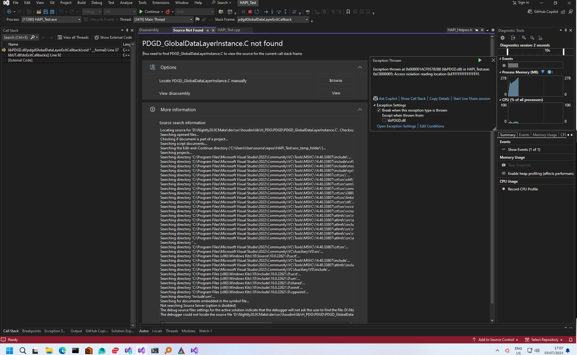

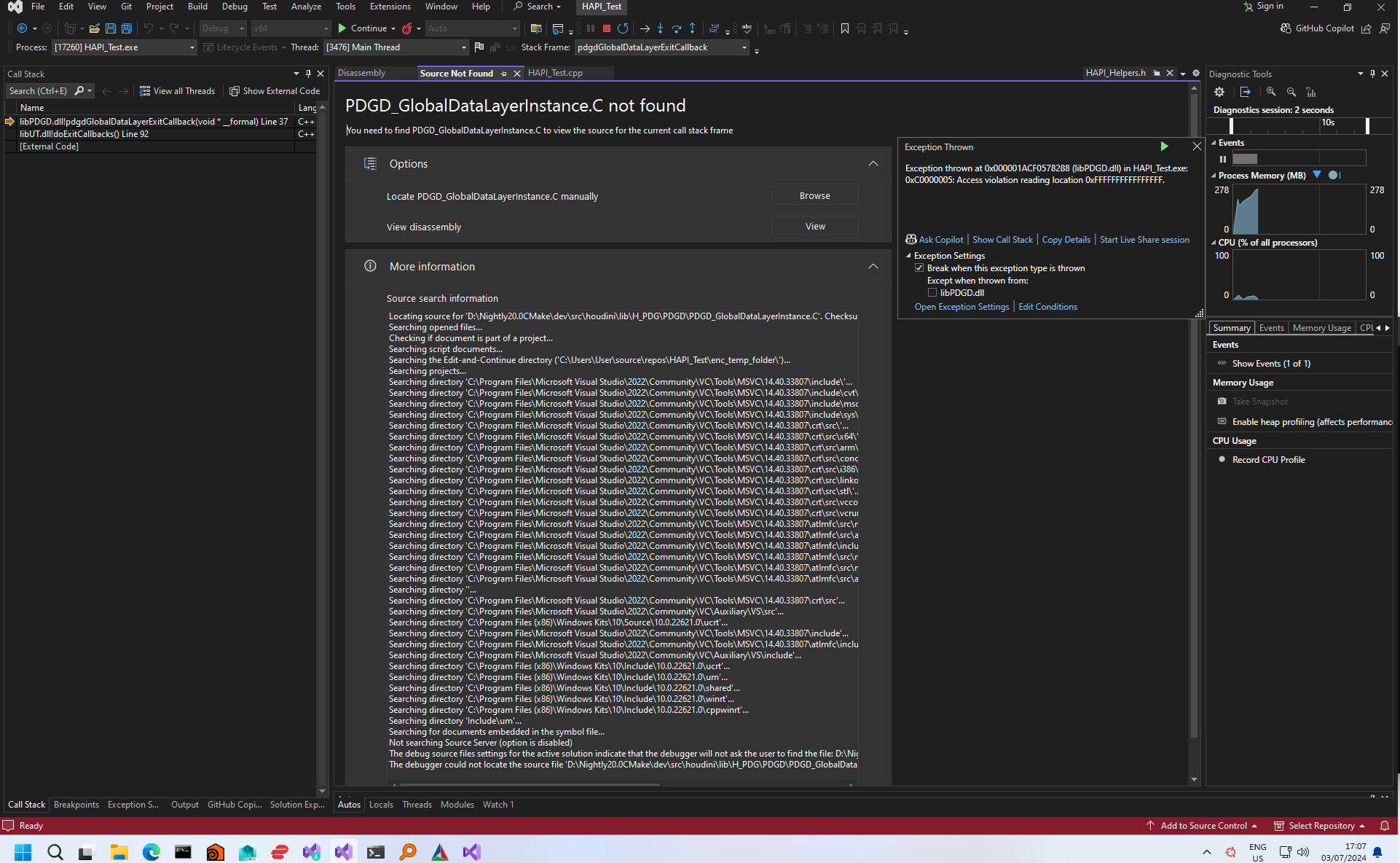

Then this exception happens (See attachment).
The exception is thrown from libPDGD.dll.
Have I forgot to do clean up something in my code snippet?
Screenshot (13).png (287.1 KB)
