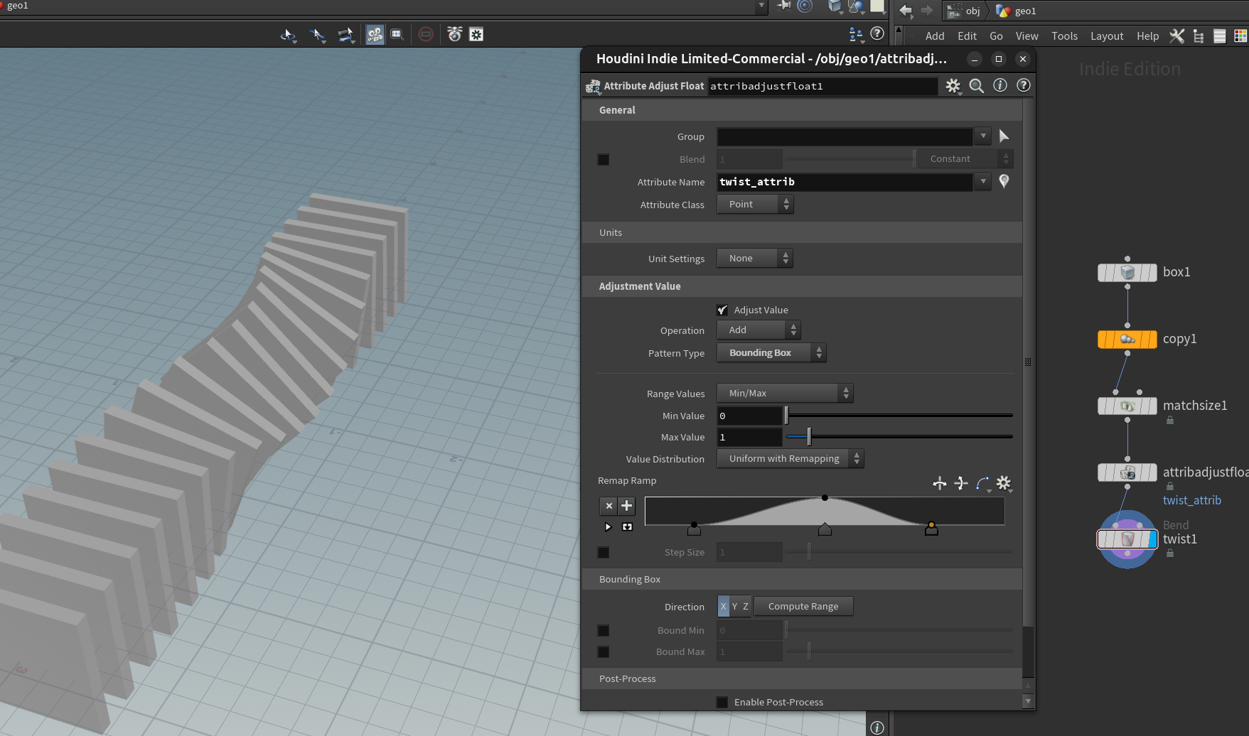

447 posts
Here's a non-VEX way that does the same thing:
