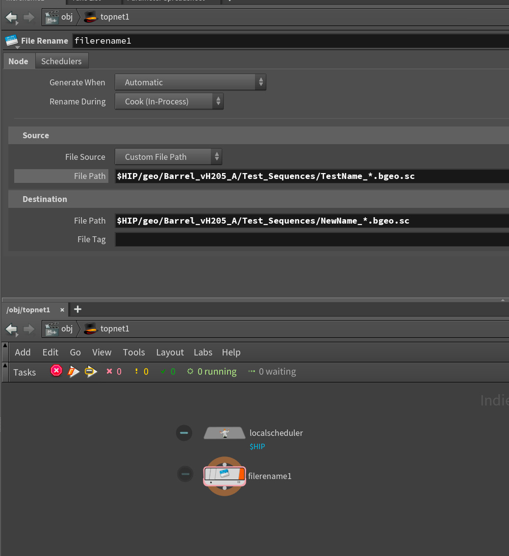

Curious to know other ways like with the TOPs file rename node to rename an existing bgeo sequence of files already on disk,
just changing a portion of the name but keeping the sequence numbers.
In the image is what I have put in the parameters as an example but when I try and dirty and cook nothing happens.
Not experienced in setting up TOPs so I don't know if that is the issue or the file rename node is not meant for what I am trying.
Renaming a file sequence is not problem in other ways for me, e.g. I can run another file cache node from an existing one and just re-create the sequence.
Or even just run a Windows .bat file which will replace the existing file sequence with a new name.
Here, I'm just curious to know of a third way if possible with this TOPs node.
325 posts
Joined: Jan. 2013
As far as I know global substitution will not work in File Rename. There are quite a few other ways to do it, I have attached some examples.
file_rename.hipnc (66.0 KB)
2184 posts
Joined: Sept. 2015
Cool...thanks alexwheezy....so that's what was missing in my case, basically needing File Pattern node.
