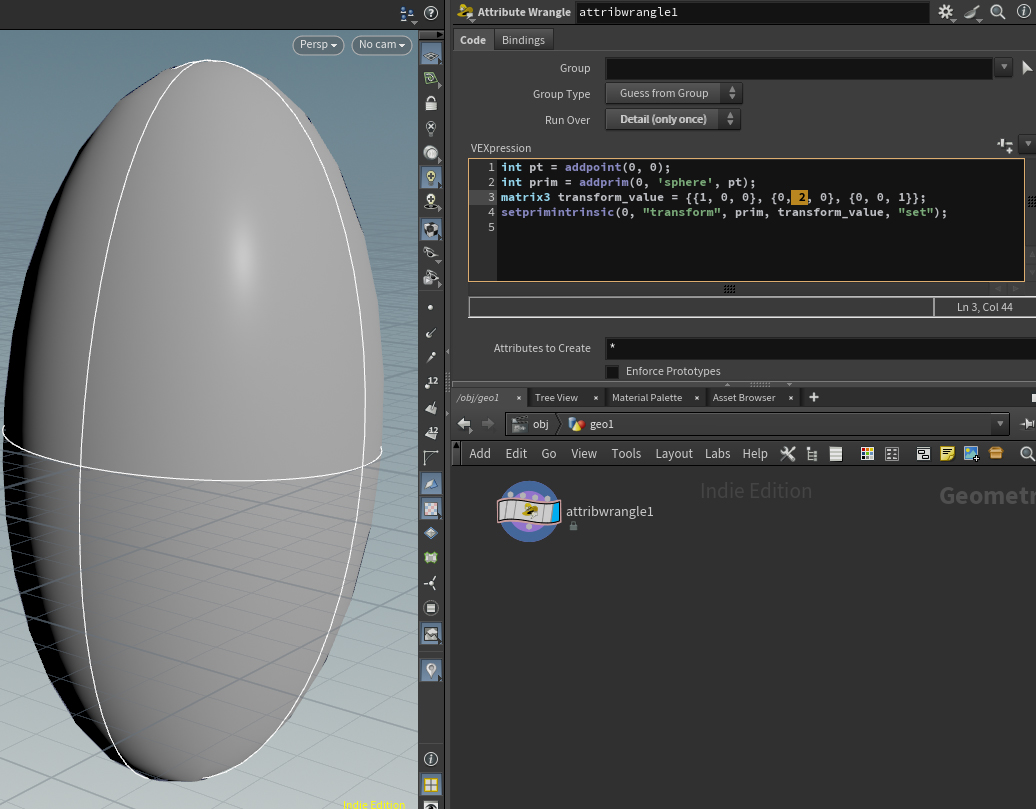

You could try something like this...
int pt = addpoint(0, 0);
int prim = addprim(0, 'sphere', pt);
matrix3 transform_value = {{1, 0, 0}, {0, 2, 0}, {0, 0, 1}};
setprimintrinsic(0, "transform", prim, transform_value, "set");

Thank you, Enivob, for your feedback on the 'setprimintrinsic' command.
It worked, and I was able to make the syntax a bit shorter for my use case:
matrix3 mat3 = ident() * 3.0;
setprimintrinsic(0, 'transform', prim, mat3, 'set');
Much appreciated for your help.
