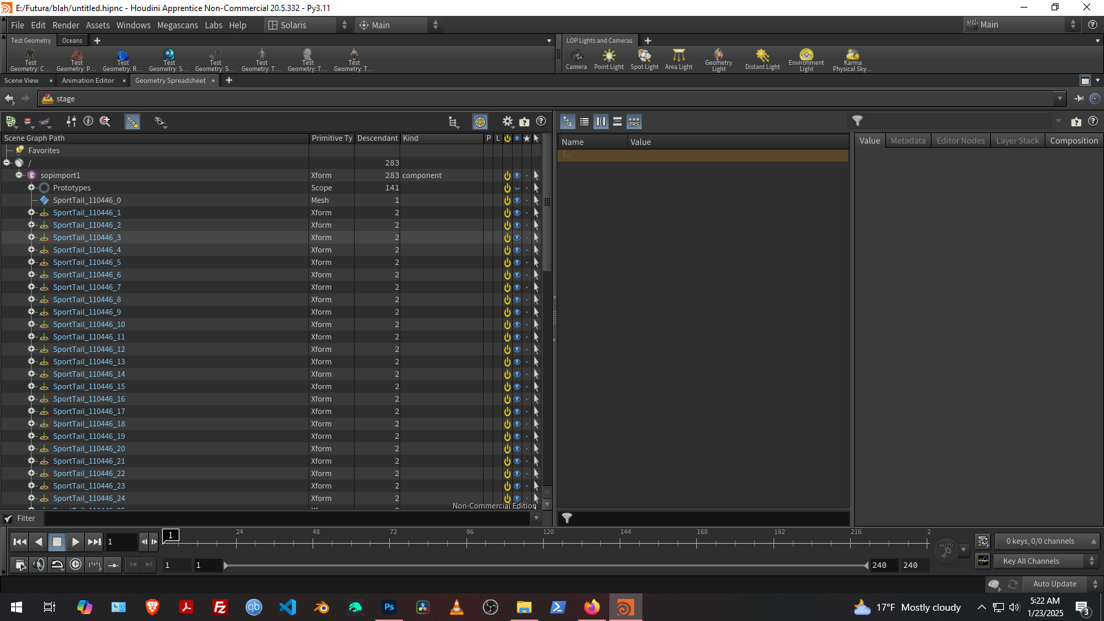

I'm importing a daz3d hair geometry and there are many unconnected points that come with it. When brought into solaris and rendered, those points are shown as black spheres. The points also come in as instanced prototypes in solaris.
How do I clean the geometry before bringing into solaris?
P.S.: The attached 7z file contains a hip file as well as the 3D model in question. The hip file is small, but part of a larger HDA I'm making. So I need an automated process to clean up the geometry. So manually selecting the disconnected points is not viable for what I'm trying to accomplish.
