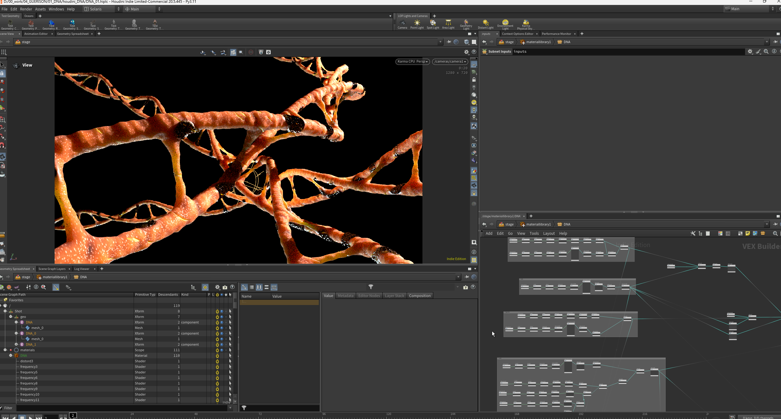

Hello everyone, I’m looking for the best way to export my scene from Solaris with MaterialX to animate and render in Maya. Do you have any suggestions?

Hi again, it seams working but I have some issue with maya and MtlX, a lot of MtlX node are red .. Do you have some suggestions?

Hard to see from the images, but I'd guess you need to change the connections from color3 to vector3.
