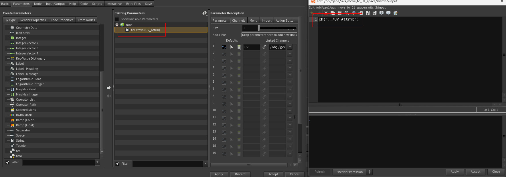

this is a stupid question because i can just use python instead..haha....
but it's killing me that i can't do such a simple thing as print this current string value and was curious if anyone knew how to do it? i seem to remember having to use tildes(?backticks?) for getting access to a string but i tried a bunch of attempts at that and all failed.
anyways, if anyone knows how to print this current var value, i'd love to hear it. hah.
string attrib.jpg (145.9 KB)

correct, but how do i print it?
for example, this is the hscript expression now. it prints 'test 0'
    test = 'chs("../UV_Attrib")';
    print("test",test);
    return 0;

never used print in Hscript, but from a quick test it looks like the second argument just expect numbers
so you need to use the first argument for string like this:
    string test = chs("../UV_Attrib");
    print( test, 0);
    return 0;
or if you want to join with other text
    print( strcat("test: ", test ), 0);
    return 0;
NOTE: since it seems like you are putting it in switch/input integer parameter so you don't need backticks at all (and if needed, when mixed with string characters in string parm, they would be around the whole expression)
