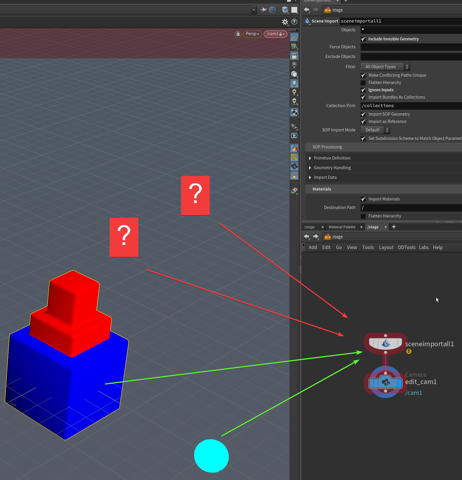

I'm not happy with the method with the instancer because I create the game level using individual objects using the snap function. I need render karma to display instance, individual items.
Thanks.

I'm afraid at present the Object-level Instance node is not supported by SceneImport. There is an open RFE for this, but it's a bit tricky to provide a robust solution. I'll try to prototype something that might work for most cases later this week.
I really hope so. Since it would greatly simplify the work.

robp_sidefxpetipet
Can you provide a hip file that shows your workflow so I can tailor the prototype to it?
Yes of course. I really don't know how it will help, I want to say that I have been studying Houdini not so long ago, before I modeled in modo mainly direct modeling.
Now I work like this: first, I import some objects to orient myself by scale.
Then using the plugin (Modeler) il using the direct method for modelig, although I am increasingly trying to use proceduralism, which I really like.
To check the correctness of the geometry, I create instances from already modeled objects and lay out the game level from them.
And for the final check, I need a preview in the karma renderer to see how the lighting works.
At first I did it in mantra render, but when there are a lot of objects, the speed of mantra preview is slowly.
I also decided to learn Solaris.
