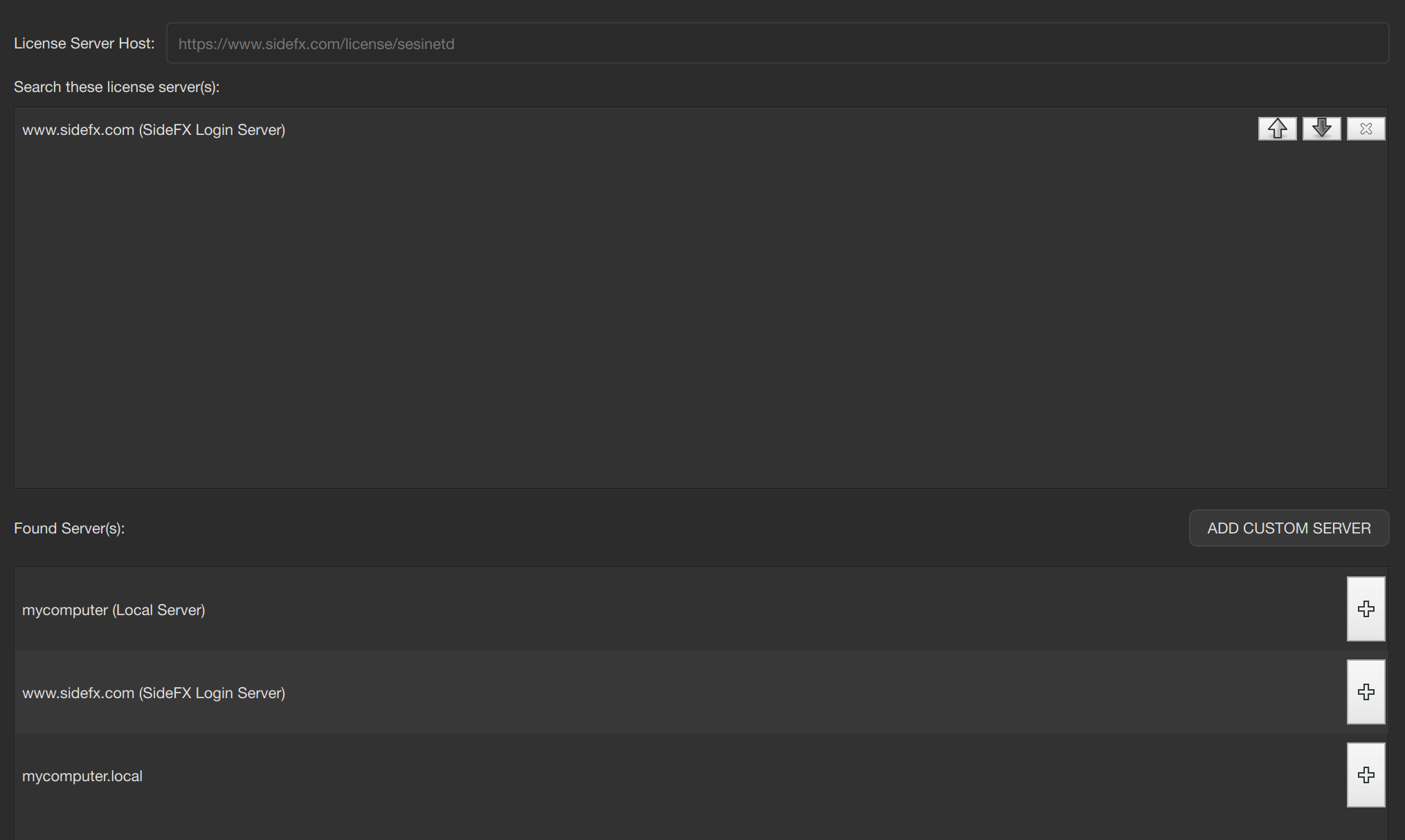

- Click on the pencil icon beside the Servers section on the left column in the License Administrator.
- Locate www.sidefx.com (SideFX Login Server) in the Found Servers(s) section.
- Press + to add www.sidefx.com to the Search Server(s) list above.
- Press the Update button to save the change.
- The license server ordering can be changed in the Search Server(s) section. This will change the ordering of what license server is used first. You can chain servers together. For example, set SideFX to be used first and if no available licenses can be found, poll the secondary server. In this case, it's the local machine.

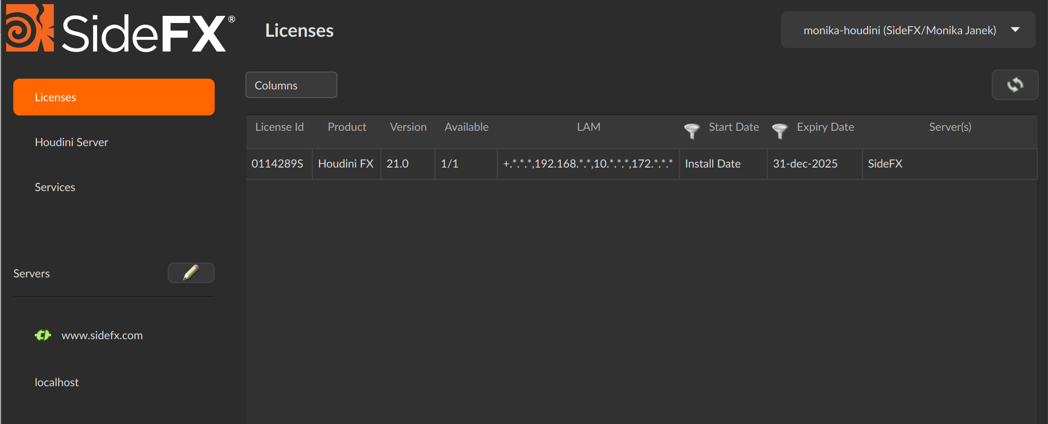

To verify that the SideFX server is in use:
Always look to the Server(s) column to see what license server the computer is using.
