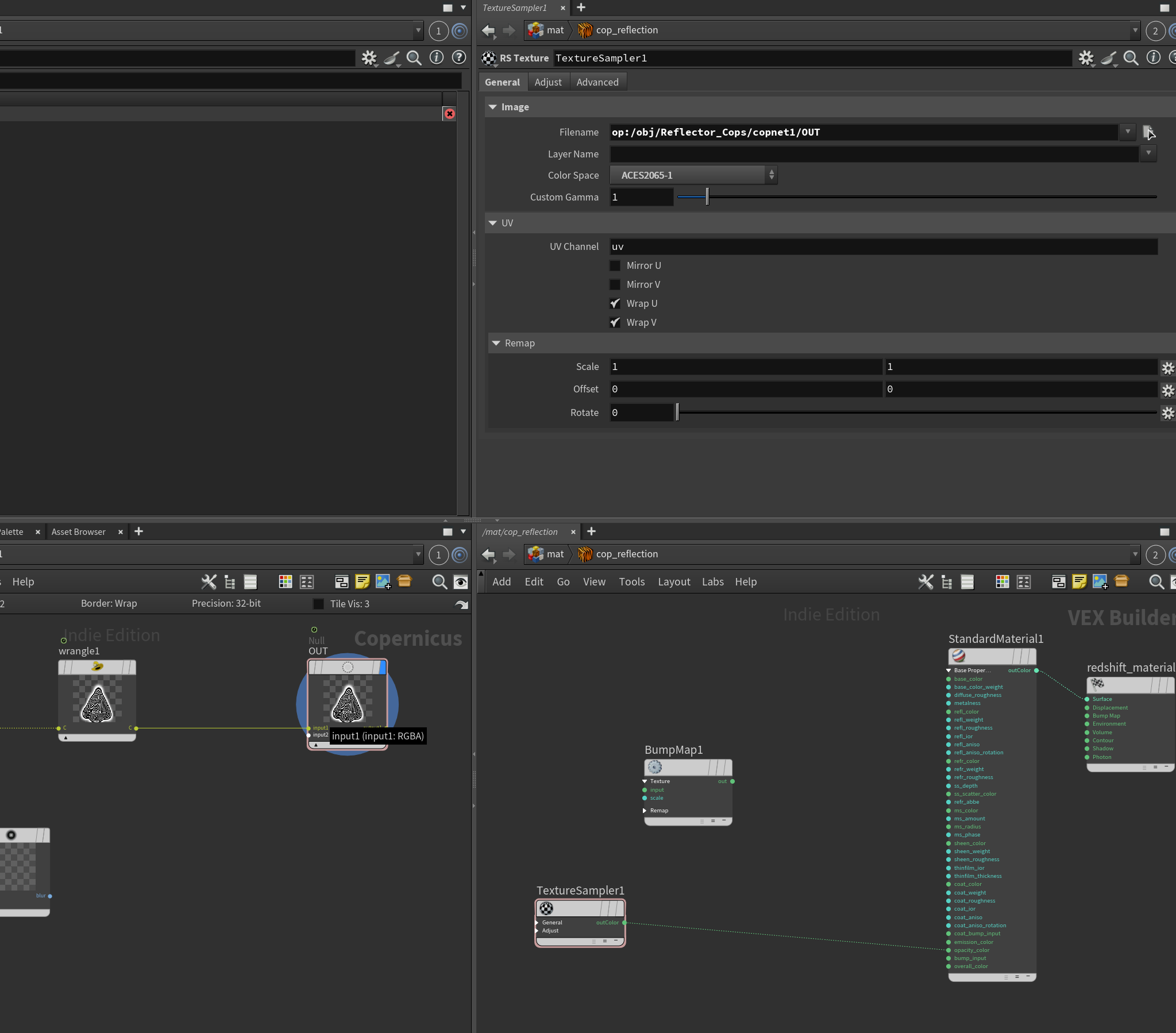

I'm trying to send a cops texture to the RS Texture node in an RS Shader.
It works when first connected then fails to find the texture from COPs.
I'm using: op:obj/Reflector_Cops/copnet1/OUT
to read the cops into the shader.
I'm using Houdini 20.5.370
Should this work?

I also encountered this problem. From the redshift documentation, the usage of "op:" is correct.
I loaded the sequence frames in COPs and played them in the view without any problems, but the rs rendering could only read the first frame.
