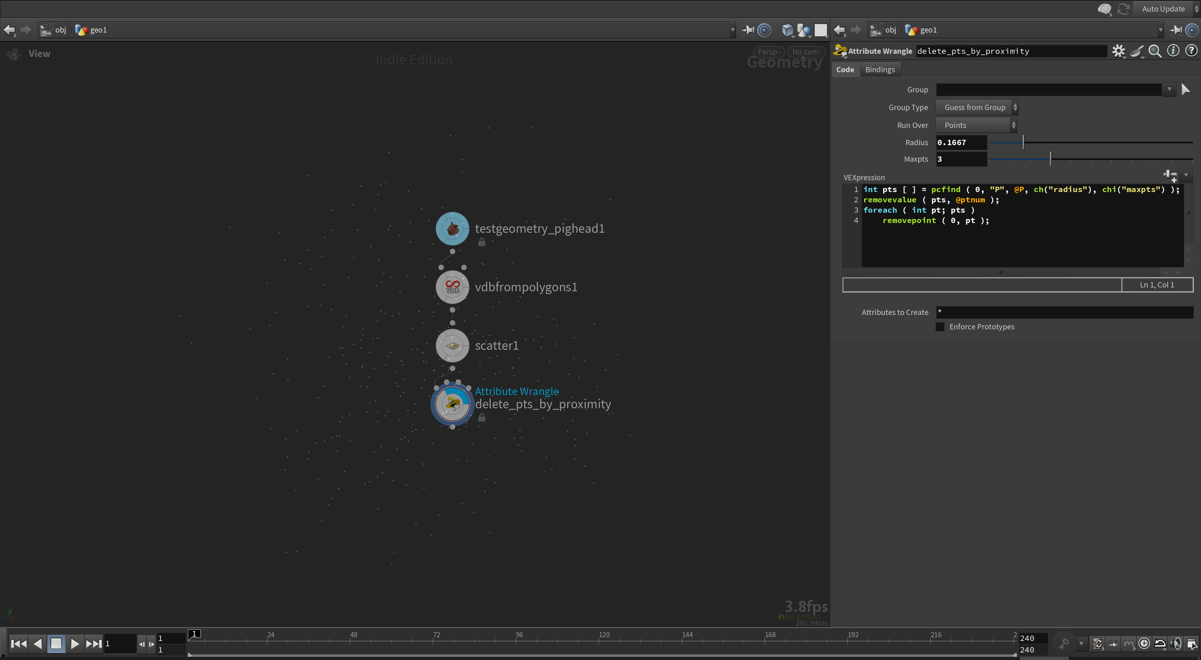

You can do this using VEX:
int pts [ ] = pcfind ( 0, "P", @P, ch("radius"), chi("maxpts") );
removevalue ( pts, @ptnum );
foreach ( int pt; pts )
    removepoint ( 0, pt );
You can use packed geometry instances using Copy to Points and then run an RBD simulation on it.
